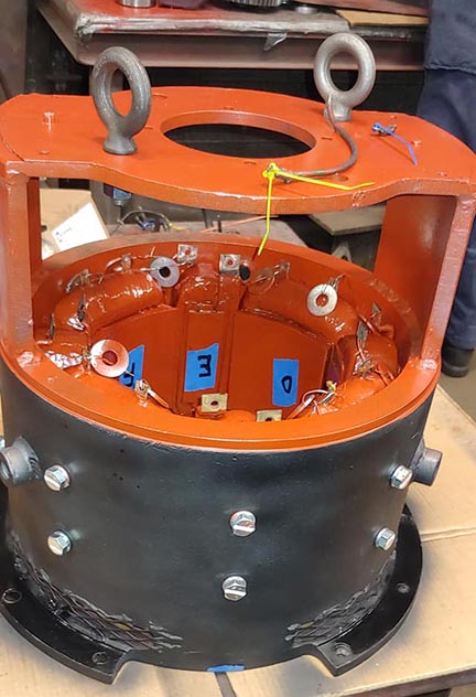

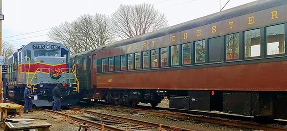

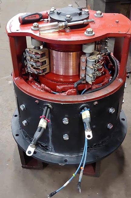

The West Chester Railroad is located in West Chester, PA and operated by the West Chester Railroad Heritage Association (WCRHA), a 501-c3 non-profit. Their Christmas trains were being pulled by ALCO C-424 (built in 1965) No. 4230 when its auxiliary generator failed. Former Penn Central GP-38 No. 7706 finished out the 2020 Christmas season for the West Chester Railroad.

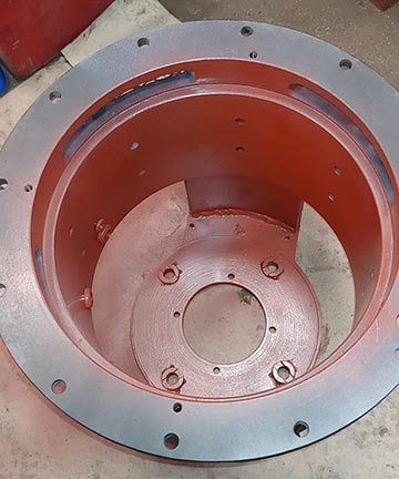

McHugh Locomotive was contracted to perform on-site and shop services to get the ALCO C-424 locomotive back in service. The auxiliary generator was removed and rebuilt at the McHugh shop. The locomotive will return back to service for the startup of the WCRHA 2021 season.

During the 2020 Christmas season, West Chester’s EMD GP-38 No. 7706 developed some electrical issues with several relays and contactors. A WCRHA volunteer visited the McHugh Locomotive and Equipment shop and JC McHugh donated the electrical equipment to resolve the problems, getting No. 7706 back into service for the WCRHA Christmas trains.

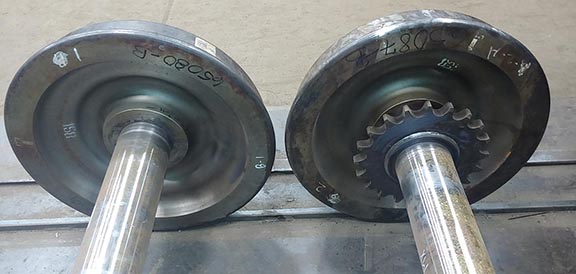

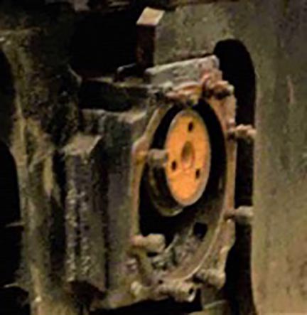

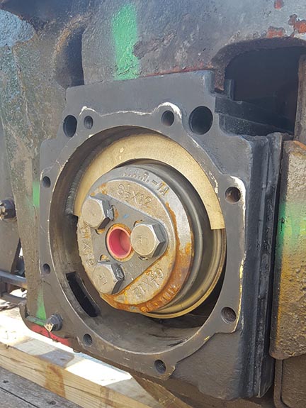

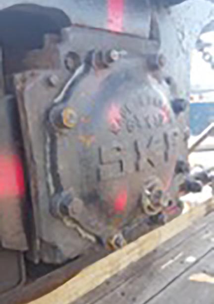

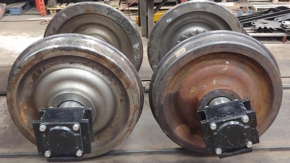

Here is another project completed for WCRHA earlier and worth sharing. Their ALCO RS-18 No. 1803 suffered a bearing failure of the axle set #1. The locomotives truck assemblies had the obsolete old style oil bath type SKF bearings that are no longer available. To restore the locomotive back to service the following repairs were made. A new axle was manufactured to AAR standards that would accept Timken 6-1/2” x 12” class F roller bearings. The new axle was machined to accept the GE traction motor support brass and the used bull gear from the old #1 axle set. The used qualified bull gear and the new Timken bearings were installed onto the replacement axle. The two old SKF axle journal box were modified to accept the Timken roller bearings. The #1 and the #2 axles sets also had the wheels re-profiled. After the truck assembly received various other repairs it was reassembled at the McHugh shop. The old SKF covers where applied to the modified journal boxes with Timken bearings to have the truck assembly appear to be historically correct.

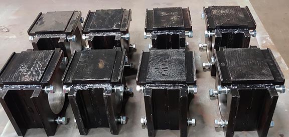

McHugh Locomotive and Equipment is rebuilding a center-cab diesel locomotive for the Huckleberry Railroad, a 3-foot gauge heritage railroad near Flint, Michigan. The locomotive is nearing completion and more will be posted on that project soon. Here is a look at some of the progress as seen in McHugh Locomotive shop. First, we see the rebuilt journals and axles.

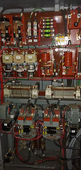

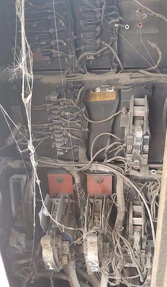

Next is a before and after of the main electrical panel for the center-cab diesel locomotive.

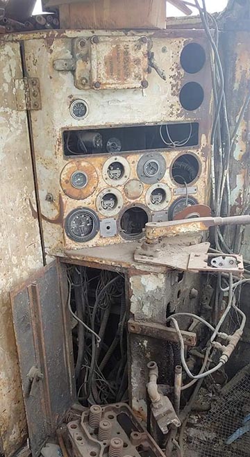

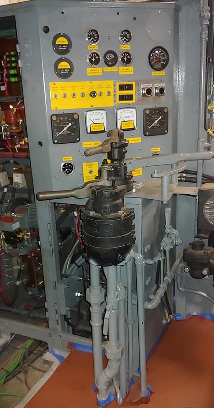

Here is a before and after of the engineer’s control stand and gauge panel.

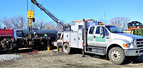

From February 5th we have a photo showing work to replace a failed D-78 traction motor for a GP-38 of regional railroad. Seen here onsite is our heavy-duty service truck with crane, welder, air compressor, and all the tools required to do the job safely.

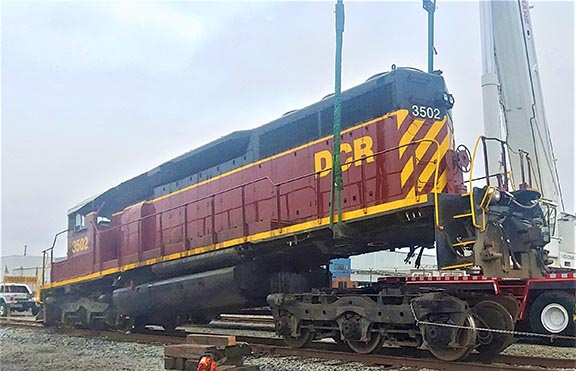

Here is a photo showing lift being made to replace a failed traction motor on SD-40-2 for a regional railroad.

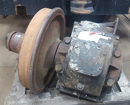

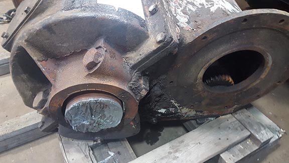

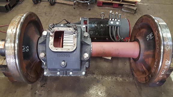

Last photos show a failed 6"x11" axle with gear box and traction motor from a American 840DE locomotive crane owned by a regional railroad. We supplied a replacement qualified axle with bull gear and a replacement rebuilt gear box. We also reconditioned the WH 1443-EC traction motor.

Kelly Anderson wrote:
tomgears wrote:
McHugh Locomotive and Equipment is rebuilding a center-cab diesel locomotive for the Huckleberry Railroad, a 3-foot gauge heritage railroad near Flint, Michigan. Next is a before and after of the main electrical panel for the center-cab diesel locomotive.
Why didn't you install 26 brakes and PTC?
The pressure maintaining feature of 26 would be useful with the small reservoir and compressors capacity of a GE industrial. (And yes, I know they replaced both)
