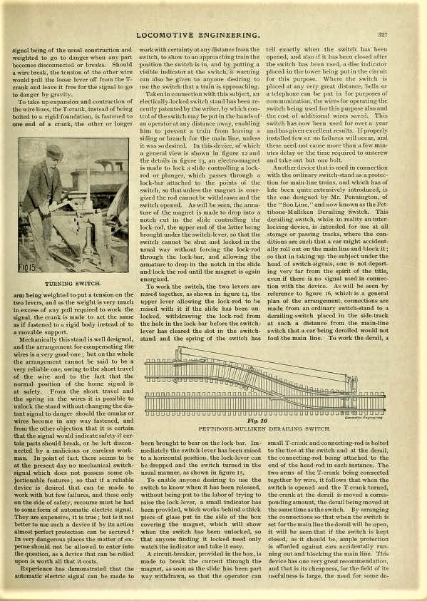

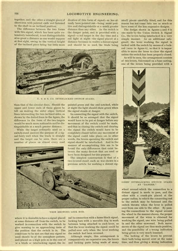

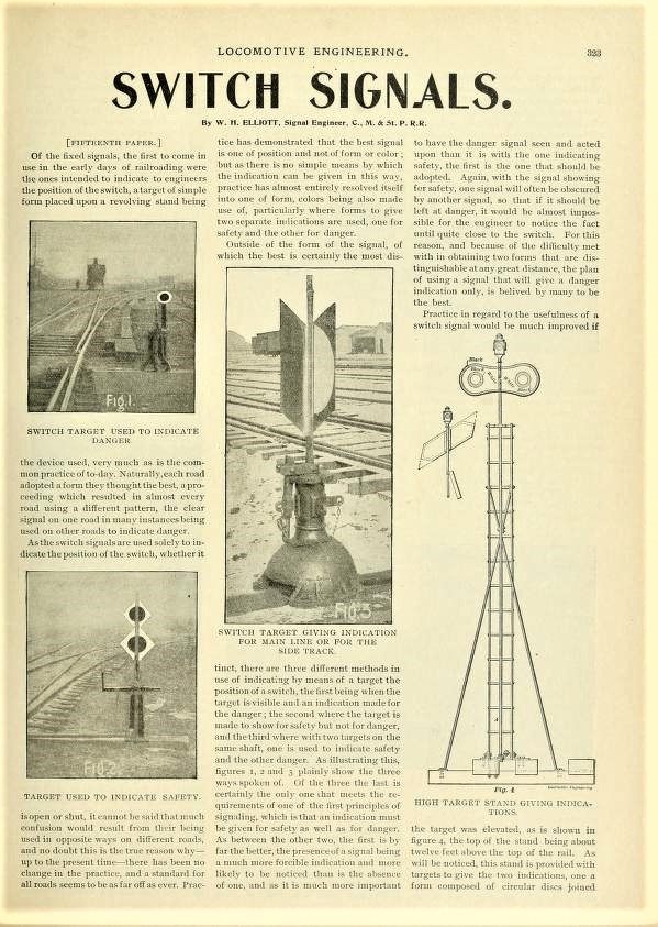

An article from the 1892 Locomotive Engineering journal about Switch Signals.

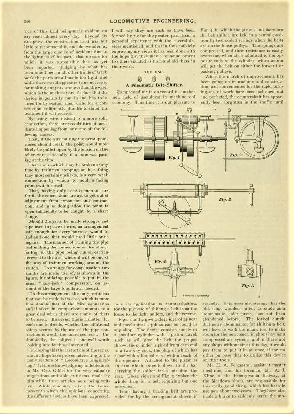

The last 3 pages
