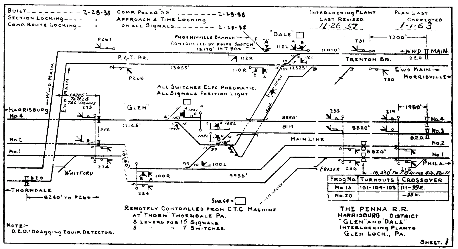

First, the P&T Branch did not connect with the Main Line Phila to Pgh at its east end. It went only to the Trenton Branch to go to Morrisville.
There's not currently much freight traffic going to Morrisville from the West. What there is mixes with Septa in Norristown going from the ex-Reading Main Line to the ex-PRR Trenton Branch.
Reading Company was able to run its frequent passenger trains between Reading and Norristown Junction (where the passenger trains crossed the river to use the Norristown Branch to Phila) along with its equally frequent freight trains. But that was then, when we had local dispatchers and manned interlockings. The RDG Main Line was partially four tracks and partially two tracks with single track through Phoenixville (Blank Rock)Tunnel.
Phil, Wow, thank you! I never realized this until I just looked at some track charts which reflects what you said.
https://4.bp.blogspot.com/-HzDos75aPwE/ ... 0/glen.gif
I also see that the Phoenixville Branch appears to be coming off the Trenton Branch and not the main, is this accurate? I always thought it connected to the main (although this chart was last updated 1963 so it might have been moved from it's original connection by that time).
It looks like the direct connection from the main to Trenton Branch has always been there, but there was never a direct connection from the P&T to main here? Regardless, I'm surprised they never made that connection, unless it was there when first constructed and disappeared by the time this chart was last updated. I suppose if it was ever there, they would have wanted a flying junction (like they have on the west end connection at Thorndale) to get the freight onto tracks 2&3 without blocking passenger trains on tracks 1&4.
Another thing I noticed on the chart: when did they remove track 3 in this area on the main? It was there as of 1950 per PRR Triumph III. I don't own that book, but it's at my local library and will have to go back this weekend to check if it's stated in there. It might also be able to clear up the geometry of the connection between P&T Branch and Trenton Branch

The junction at "GLEN" (Glen Lock just West of Frazer) currently has the Amtrak Harrisburg Line splitting and a junction with the NS Dale Secondary (PRR Trenton Branch) beginning between the two Amtrak directions with a duck-under dating to PRR beneath the Westward Amtrak Main.
A 1963 diagram shows Main Line tracks 2 and 4 (track 3 had been removed West of "GLEN") with connecting tracks to a lead to the Trenton Branch Ewd Main and a crossover to the TB Wwd Main. There was no connection to ML Track 1. A new ML Track 3 to the East originated at "GLEN" and the TB connection ducked under ML tracks 3 and 4. There was no wye or Phila to P&T connection.
The Phoenixville Branch entered the TB Wwd Main with a facing point hand thrown turnout with an electric lock. The West Chester track connected to ML track 1 at Frazer with a trailing point hand thrown turnout. This does not preclude the two lines having once been through, crossing the Main Line (Phila and Columbia R R) at grade.
SEPTA's push-pull shop is at East end of Frazer.
Phil, I think we're on the same page now; it must have been quite a busy spot back in the day. With all the diverging lines here, was there ever an interlocking tower here? If so, I wonder when it was closed (looks like it would have been pre-1950). I know SEPTA completely rearranged the tracks here again in the 80's(?) when they moved the layover yard/shops to Frazer from Paoli. Do you know when track 3 was removed west of GLEN? I know it was there as of 1940's per PRR Triumph III.
