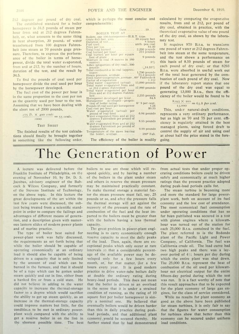

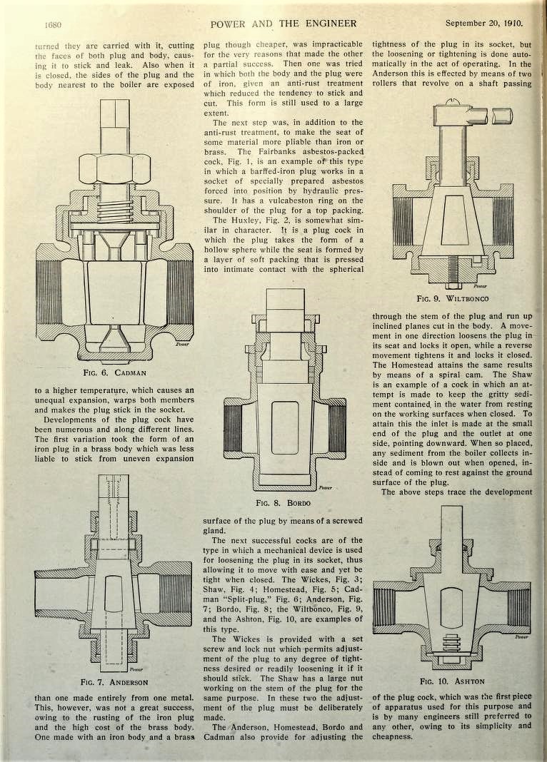

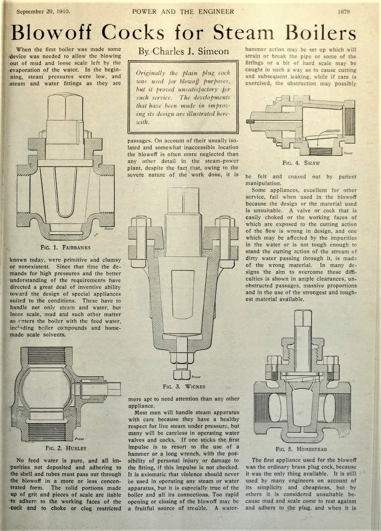

Power and the Engineer Magazine 1910
A couple of steam boiler articles

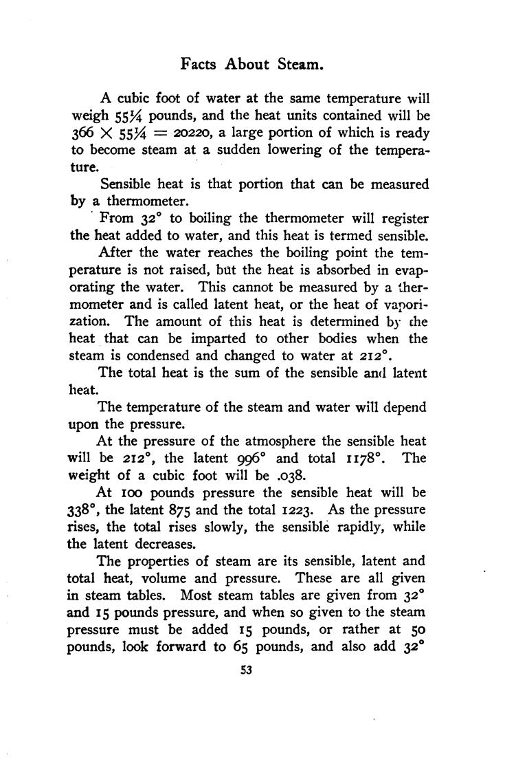

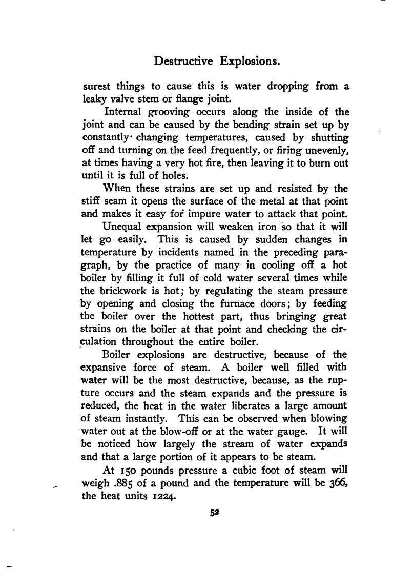

The section on boiler explosions from the 1917 book.
American Stationary Engineering: A Practical Work which Begins at the Boiler ...1917
by William Edward Crane

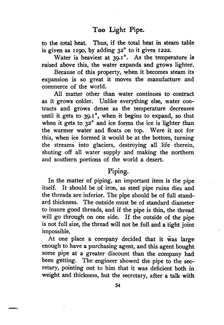

And the last page

This non-scientist learned something about the physics of water from this last post, like the maximum density of water being above 33 degrees F. I did not know that. Thank you.
