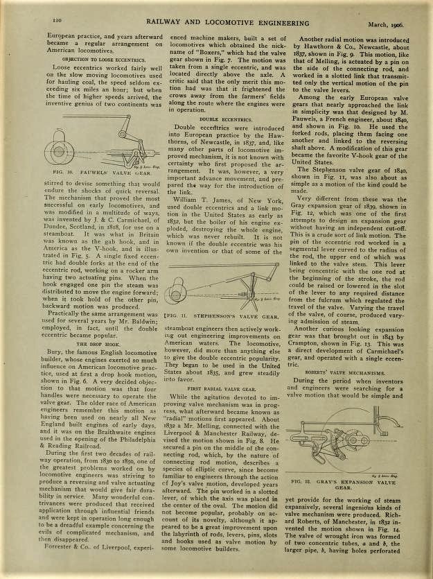

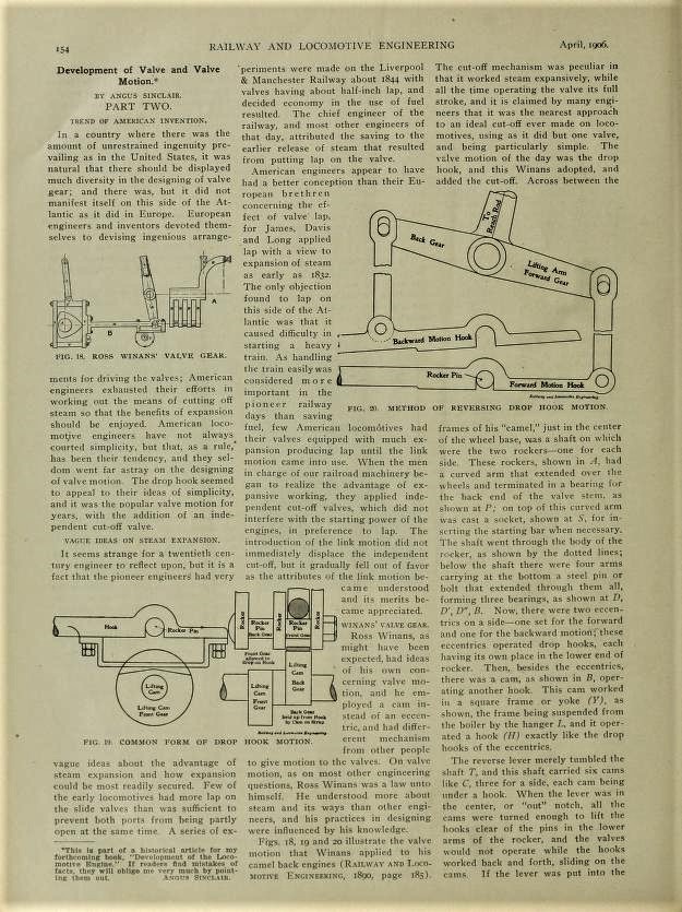

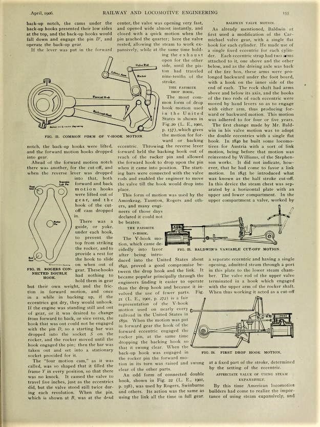

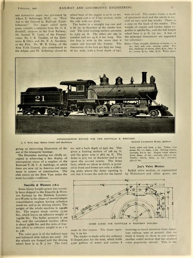

From the 1906 edition of Railway locomotive. An article about valve gears.

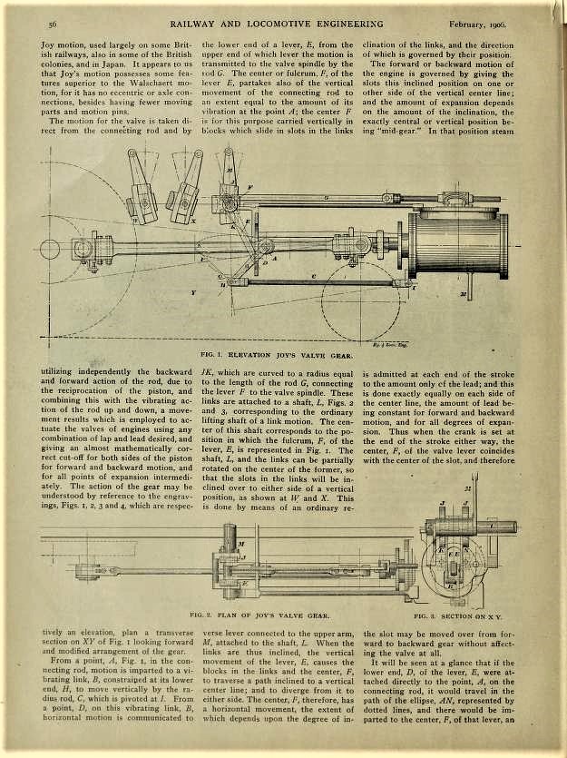

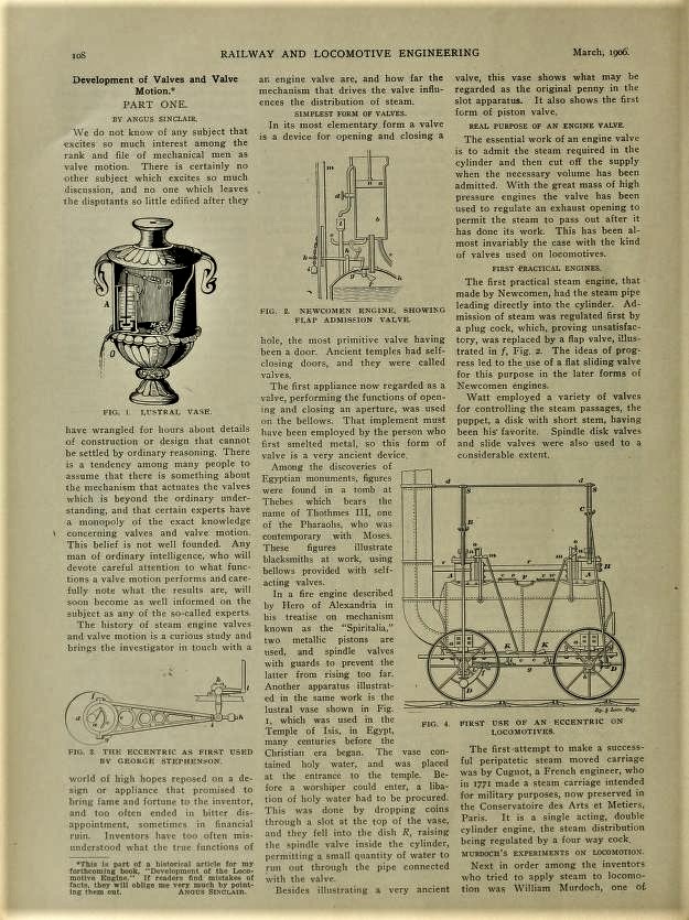

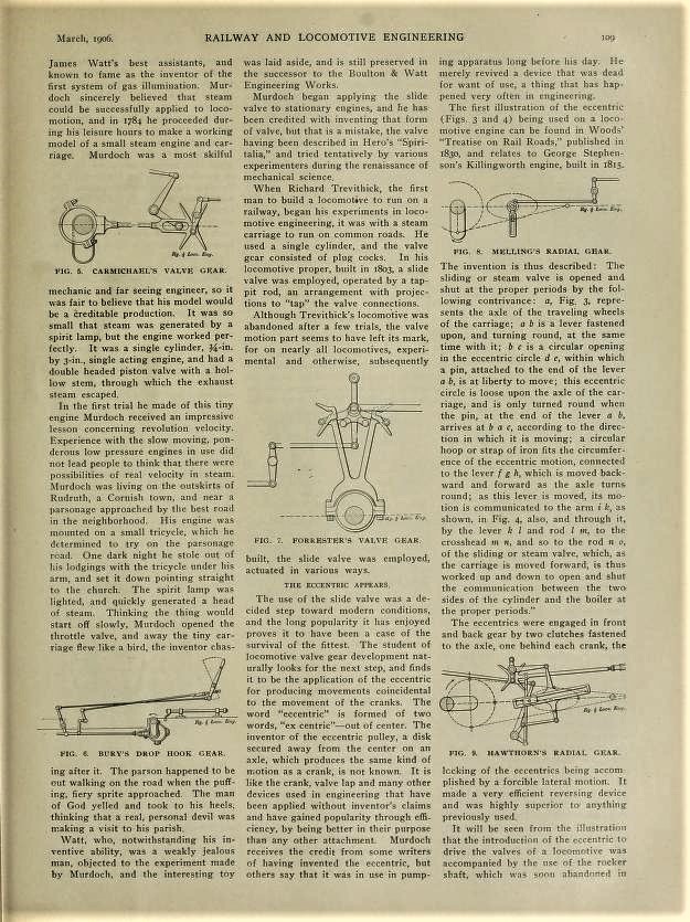

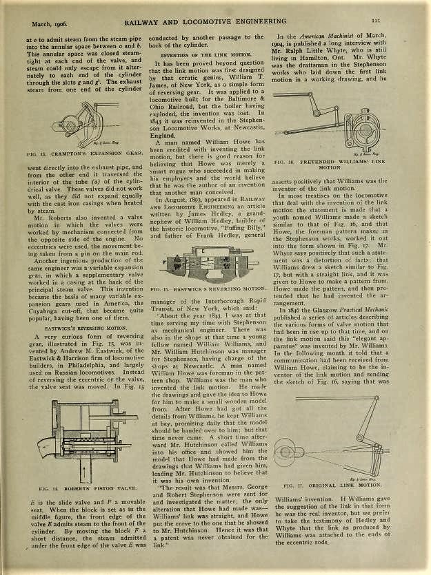

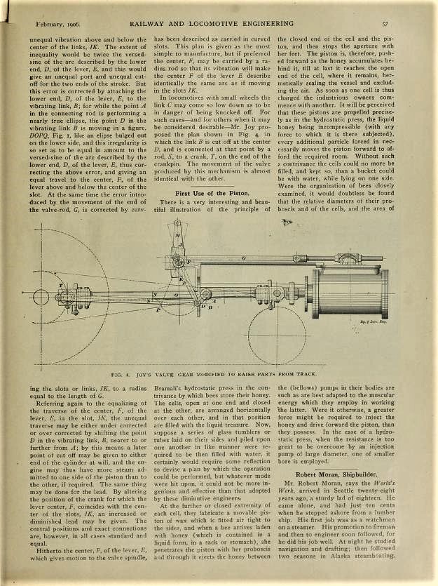

part 2

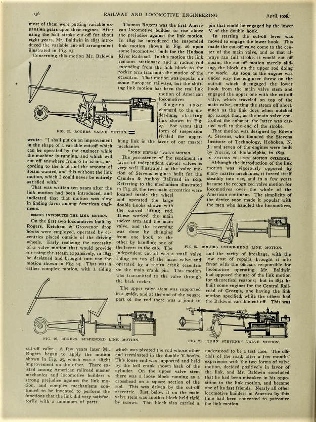

An earlier article from the May issue about valve motion.

part 2
