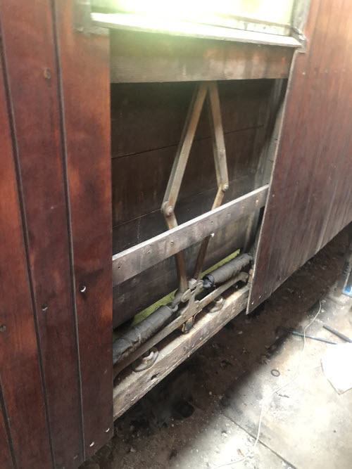

Ever wondered what keeps those windows up on European coaches?

For what it's worth-we picked up a cheap and effective alternative to keep coach windows up. We installed cheap hinges...swing them in, window stays up. Swing them out, window goes down.

That’s quite the contraption just to hold up a window. I would have to guess that maintaining a fleet of cars with those in them is not inexpensive as compared to US practice.
