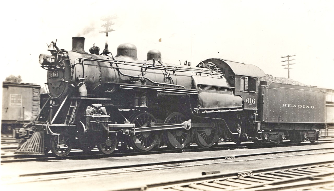

Another Reading camelback L-7, 603, was in a collision with a PRR train at Sunbury.
Reading Shops rebuilt it as an end cab engine renumbered 616 (and with Caprotti poppet valves!) and the 616 was 4 feet longer than it had been as 603. Same tender.
That's pretty interesting. I found some pictures of the 616, compared to others from a similar class (since I couldn't find a picture of the 603), and it's neat to see how the cab was added:
The size of the domes is also reversed, with the 616 having a larger dome towards the front of the engine, while the other locomotives have the larger dome towards the rear of the engine.
