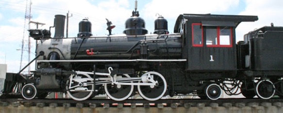

Today I browsed some 20 year old photos made at the Galveston RR Museum.
Engine in question is
Waco, Beaumont, Trinity & Sabine RR #1 a Baldwin 2-6-2
I can NOT trace any of the available info about this engine back to the original/first owner/operator
of this locomotive. I did NOT find any matching info in my Baldwin data.
Does anyone have the class designation/line number of that engine that I can trace back within Baldwin records?
If the cylinder-diameter at steamlocomotive . info is correct it should look like this:
10-24-1/4-D,xxx
Or maybe someone can match the supposed serial number 53413 to the line number?
https://www.steamlocomotive.info/vlocom ... splay=1173
http://wbtsrailway.net/photos.htm

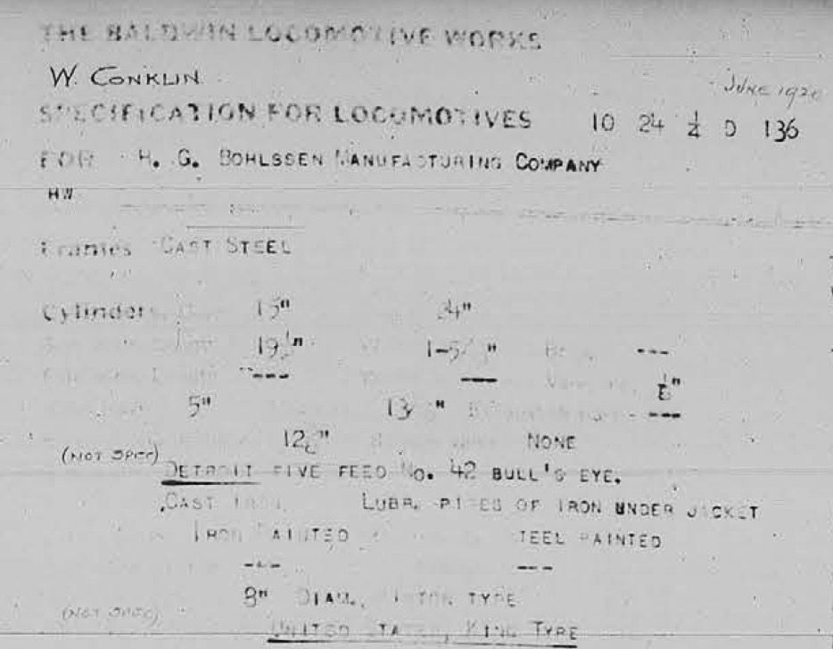

Specification information appears in the SMU Baldwin Spec book Volume 65 page 31 and following three pages. This is the missing 136 of the class.
(This also happens to be the PDF double page number 31 and 32)

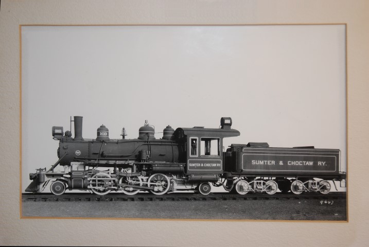

The BLW classification covers some rather different locomotives: the 2-6-2 in question, #1, has piston valves (superheated?) and asymmetrical driver axle spacing.
This locomotive is 10-24 ¼ -D-160. Slide valves, symmetrical driver axle spacing. Built for Allison Lumber Co., owner of the S&C.
Some locomotives in the 10-24 ¼ -D class had larger diameter boilers, some tapered and some straight.
Seems like a very strange "classification" system....

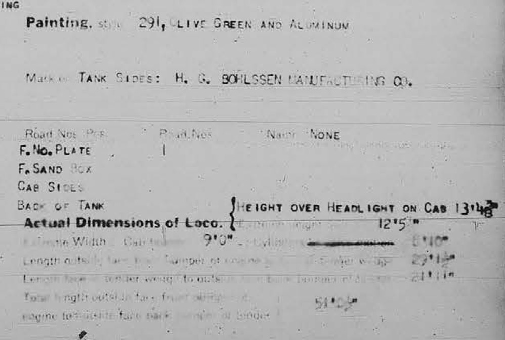

My problem is that I have no access to the construstion number list.
I have only the SMU public available records and as you mention in the index this one is missing.
I then checked the most logical 62, 65 and 71 but not find it.
Thanks to Brian Norden I found it in 65. My fault that I not found before.
Yes it is 10-24-1/4-D,136.
That pages are very very very light scans - almost unreadable. That maybe the reason this engine
is not listed on Wes Barris database.
Again thanks to all for help!
