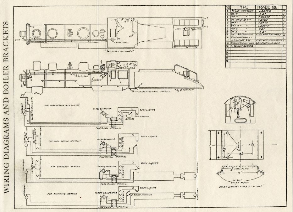

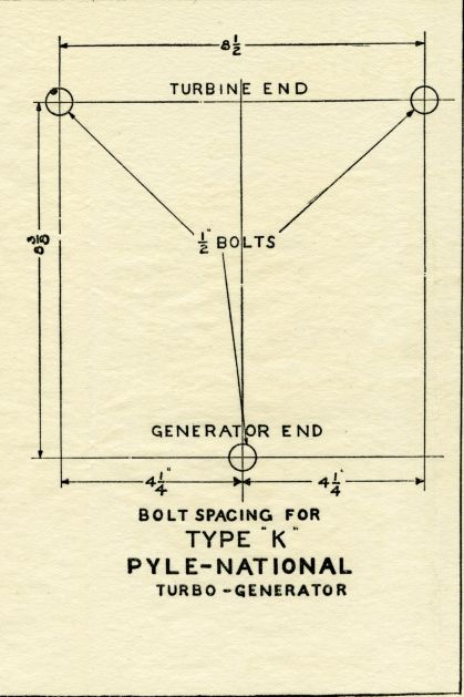

I am looking for a copy of the manual for the K2 / 240 turbo generator that would instruct me how to adjust the governor and how to wire it in. Looking to install one this weekend on the 58 and would like to do it right.

Rick - We have a digital copy of a 1918 K-2 brochure and parts listing with some information on their care and feeding in the Engine 557 Restoration Company tech data archive. I got it from the Henry Ford Museum via interlibrary loan. Below are the most relevant pages to installation. Send your email by PM and I'll send the rest of the publication to you.
