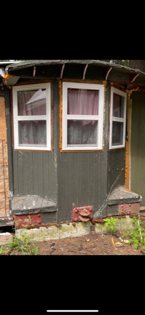

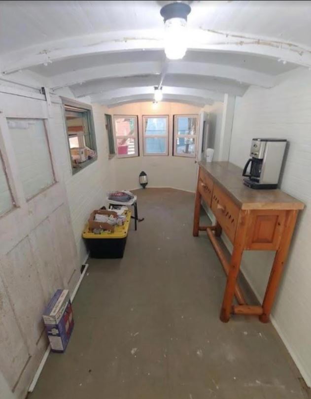

We purchased a property in the Lake George, NY area with an older trolley car on it. It was used as a camp for many years and we are looking to restore the car. However, we know very little about the rail history and have had difficulty finding information locally.
We know the car was originally stained dark green and has original stamped step boards. The original slider door is still in the car and all locations for doors/windows are intact. The neighbors believe this was moved onto the property in the 50s.
Just looking for comments or a bit of history anyone may know on the cars.
We are curious what the original interior looked like as well as the original rail line.
File comment: Interior (current condition)

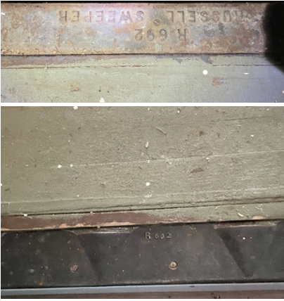

File comment: Floorboards
File comment: End of car

Sam Freeman of Adirondack (New York) Rwy. did acquire a snow sweeper from Philadelphia Transportation Co. in the mid 1970s, but it was built by Brill. The pin for the tow bar was mounted lower than the one in the photo.

Well that is an odd carbody to acquire for a cabin. It is a sweeper, a snow sweeping vehicle. It never had passenger seats, and the interior was pretty bare. Just some mechanical equipment and room for shovels and tools. A crew rode it out to sweep snow off the track, and they stopped occasionally to shovel spots that needed attention.
It is smaller than a regular streetcar, and that is probably why they selected it.

Steve, Russell did build large and long double truck snow sweepers. The motors for the brooms would be inside.

This is an interior shot of sweeper C145 at the Baltimore Streetcar Museum a few years back.....

Sorry for not getting back to you sooner on this, I've been having issues with accessing my email while traveling and I just returned tonight from a business trip. I saw that on RyPN - pretty interesting! My guess, given its location, is that it's from the Hudson Valley Railway, an interurban line that ran from Albany to Warrensburg past Lake George, which apparently is where the body is. Of course the car could be from almost anywhere - the Albany or Schenectady city systems, one of the many lines in Massachusetts, or somewhere further afield - but most bodies tend to be from local systems and HVR is the local system. Unfortunately, while there's a book that was written many years ago on HVR, I don't own a copy and there are vanishingly few photos from the company available online.
Most Russell sweepers built in the 1920s had nice curved ends, but there's a 1912 Russell-built work car from the Newark subway that's preserved and it has a three-panel flat end similar to the upstate New York body. So this may just be a slightly older Russell.

As to using a retired sweeper for a shed, look at the Philly sweeper interior in this thread. Take out the sweeper parts and you've got a big wood box that can hold almost anything.

The owner measured the interior length as 32 feet. Would that be typical of a single truck sweeper?

At 32’ it’s in the range of size for a single truck sweeper. For comparison, Public Service (NJ) single truck sweepers were just over 30’ in length.
Interesting to note that the side window placement, side door, and end construction are quite similar to PS single truck sweepers.

Looking at the roof line over the front platform, could this body be home built by a traction company using castings and machinery supplied by Russell?
