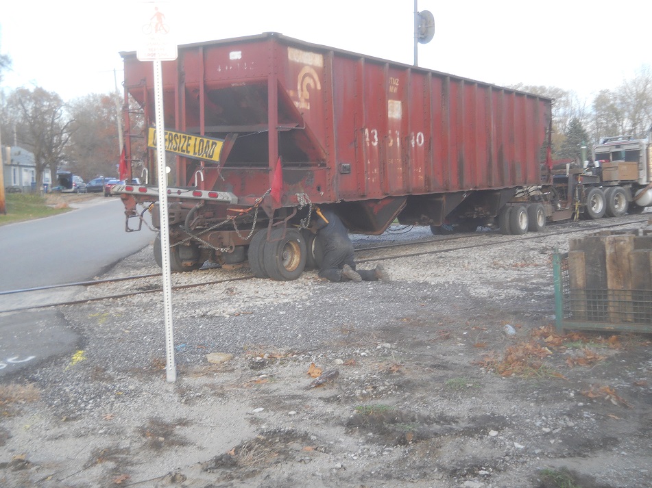

Late yesterday afternoon, Schlatter Boys Trucking delivered CR hopper car # 435140 to the Hoosier Valley Railroad Museum. The photos first show the car being moved into a position to remove one of the highway bogies, then the bogie being moved out and the railroad truck being rolled into position under the car. It was a very long process, ending well after dusk, which precluded getting a photo of the car as it sat on HVRM track.
The car is a Class H39 hopper, originally built for the Pennsylvania Railroad as PRR 665244. I checked the internet and couldn't seem to find any firm info on these cars. Some stuff said built in 1955, others 1959 and others in the `60's. Also some photos of PRR H39 cars in black paint, others in freight car red. Information on its PRR heritage is needed.

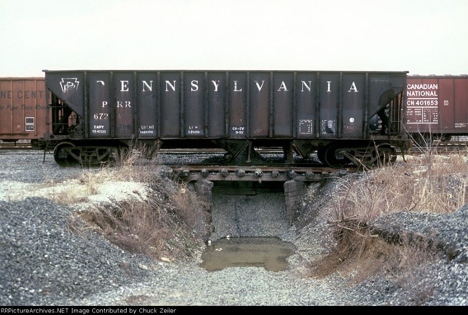

"PRR H39 672422, Jeffersonville, Indiana, May 29, 1984, photo by Chuck Zeiler. According to the October 1971 issue of the Official Railway Equipment Register, the PC had 2477 of these cars in the 665000 to 674999 number series rated at 154,000 pounds capacity. In addition, there were 7018 cars in the same number series rated at 140,000 pounds. This particular car is stencilled as one of the 154,000 pounds capacity cars."

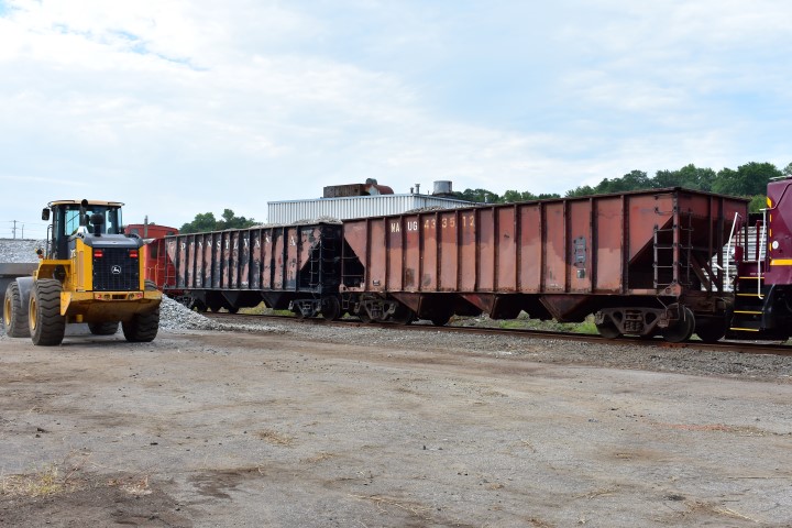

Photo shows our two H39s; the red one is the H39A, with the 1978-era replacement trucks. The other one was painted black in 2001, and the topcoat hasn't held up well.
The cars were being loaded with ballast in this photo (2016).
