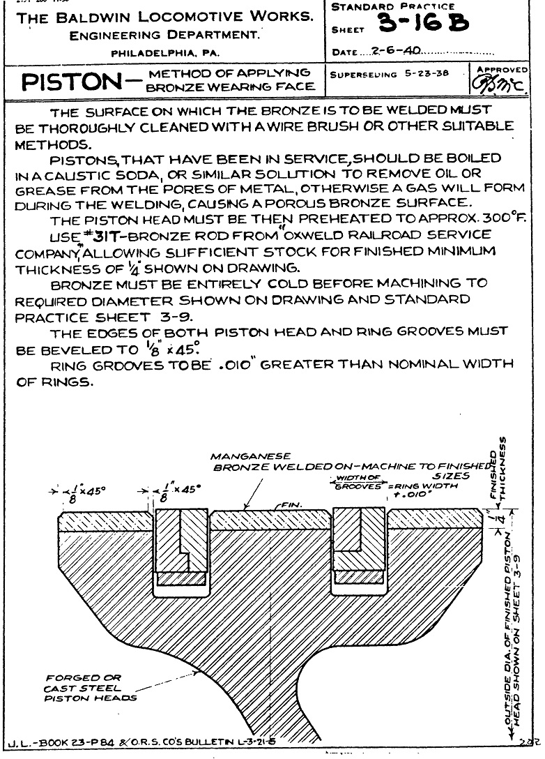

Also on the same topic, I am curious about cylinder tolerances. 58 has a 15" bore. What tolerance should there be ideally between the ID of the bore and the OD of the piston? What tolerance between the width of the rings and the width of the grooves and the space between the ends of the rings when installed. Once I pull the pistons I can determine how out of round the bores are. I am not planning to rebore the cylinders (unless the out of roundness is severe), just doing some work to the pistons and rings to reduce blowby.
Is building up worn pistons with bronze a recommended practice, as shown in this Baldwin spec?

If I'm reading the BLW sheet correctly, the groove should be .010 wider than the nominal dim of the rings.

Adding additional bronze to cast iron parts and then machining back to tolerance is a well known repair technique. I have also done it to build up badly worn brass/bronze bearing parts.
Most brazing rods have a higher tensile strength than cast iron.
Cleanliness is essential, especially on cast iron where oil can get into the "pores". Heating the parts in an old oven to burn off the oil can work.
Also preheating is necessary so the added material will bond well to the base material.
Work in layers, braze all the way around in one layer, then chip off any flux, wire wheel and add a second layer if necessary. Use a new clean wire wheel so you don't contaminate the surface.
In the absence of any other tolerance info a "running slip fit" should be about 1 or 2 thousandths of an inch smaller per inch of diameter, so the OD of a 15" piston should be at least 0.015" smaller than the bore. Depends on straightness of the bore, roundness, etc.
For round parts some kind of slowly rotating welding positioner can help. Even having the piston rod with the piston attached on some rollers and turning it by hand will speed up your progress.
Good luck.

Building up the piston with bronze to correct wear has been a good repair for us. Currently doing this on a uniflow type piston. Since those are longer only applying bronze to each end at the ring grooves. Turning the area to be built up gives a clean consistent surface to work from. This one we honed 60 thousandths over we were able to get the cylinder to the shop and in the power honing machine. We have honed cylinders that size in place by hand about 20 thousandths. It is time consuming and not a lot of fun but can be done. If it needs more than honing will fix making new pistons is a better option. We have used Niagara Piston ring they can have a long lead time but quality has been good. You will likely find it is worn a more than you think.
