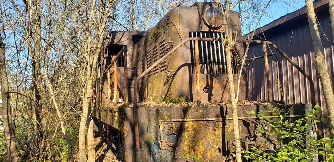

Per facebook posts from Mike Tilley with the Watauga Valley NRHS chapter, there is a 1943 Porter diesel in Bristol, VA. Used in conjunction with the Bristol & Northwestern shortline. Last operated 30 years ago. Rebuilt trucks, but friction bearings. Will have to be trucked out. Owner is willing to let go for scrap value, but time is VERY limited.
Any serious offers, please get in touch with Mike Tilley of Watauga NRHS. I do have a phone number for Mike Tilley if needed.

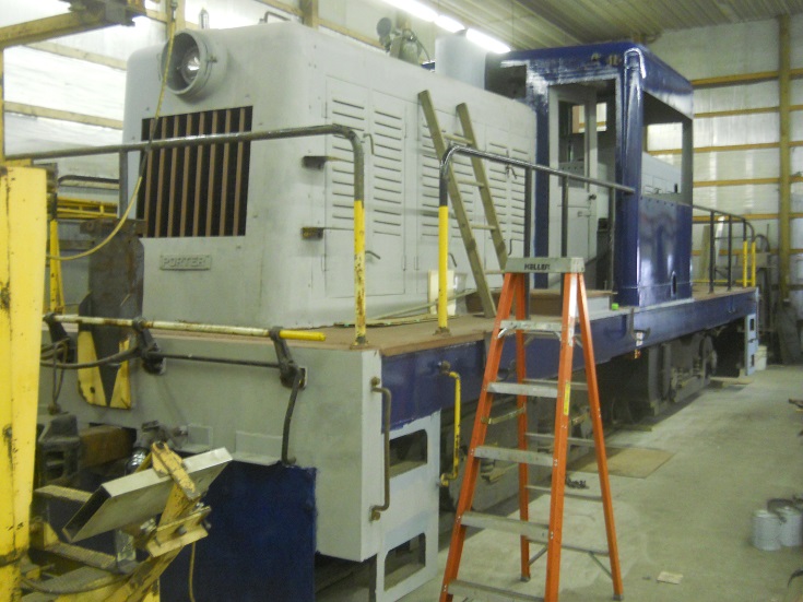

The Porter diesel there in Bristol, VA looks as if it could be a sister to the Porter here at the Hoosier Valley Railroad Museum. Our Porter is s/n 7391 built 9/42 and is a Model DE65. The Porter there in Bristol does have a different headlight casing, but otherwise seems to be similar. The photo shows s/n 7391 in HVRM's Shop as she undergoes a slow but steady restoration to active service. Not sure how many of these DE65's were built, or just how many still survive. Would be nice if some organization could save the engine in Bristol.

I was provided this information by Mr. Tilley:
It looks like about everything is still on engine and the trucks and traction motors were rebuilt just months before it was parked in 1990. It can be trucked out but with it setting out in weather and the windows broke out, it's going to be a rebuild. I understand it's 55 tonner.

According to the sources I'm looking at, this should be a 65-tonner, not a 55-tonner; Porter built 45- and 65-tonners, with 49 of the latter built between 1942 and Porter being taken over by Davenport in 1950. The specifics of this loco date it to the "middle" phase between 1943 and 1946 or so.
