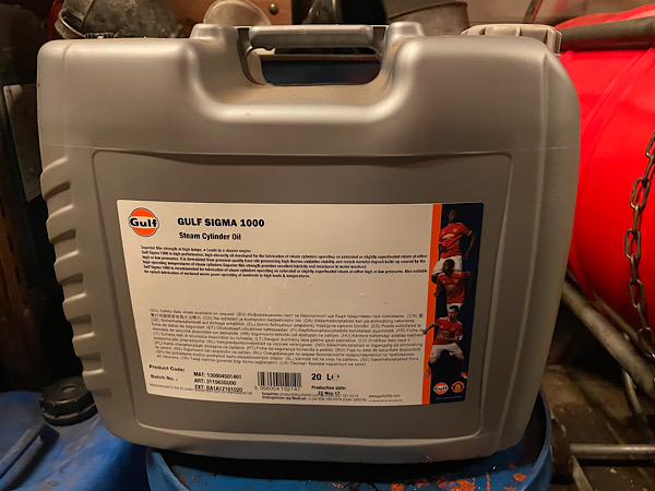

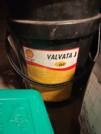

Right now, we plan to stock two different oils, because we have a saturated engine coming into service in 2022. But we also have two different servicing locations, so that means stocking two different inventories at two different locations. Is this really necessary? If we have oil satisfactory for our superheated engines, can we just use the same oil for the saturated engine?
File comment: This is our saturated oil

File comment: This is our superheated oil

Thanks so much. Will anyone dare say anything specific about the oil in the photos?
This is not useful at all, but I was curious that Gulf Oil was still being sold as they disappeared in the 1980s (growing up in the early seventies my tiny little town had a Gulf station), I found out that in Europe Gulf Oil products are licensed to this group: https://www.hindujagroup.com/ Gulf Oil was one of the so-called Seven Sisters oil companies, and is the origin of the Mellon family fortune, including Mellon Bank and the current Pan-Am Railroad.
 Post subject: Re: Choice of steam oil
PostPosted: Wed Nov 24, 2021 8:05 pm
Never seen them in use in the USA and know nothing about them.
