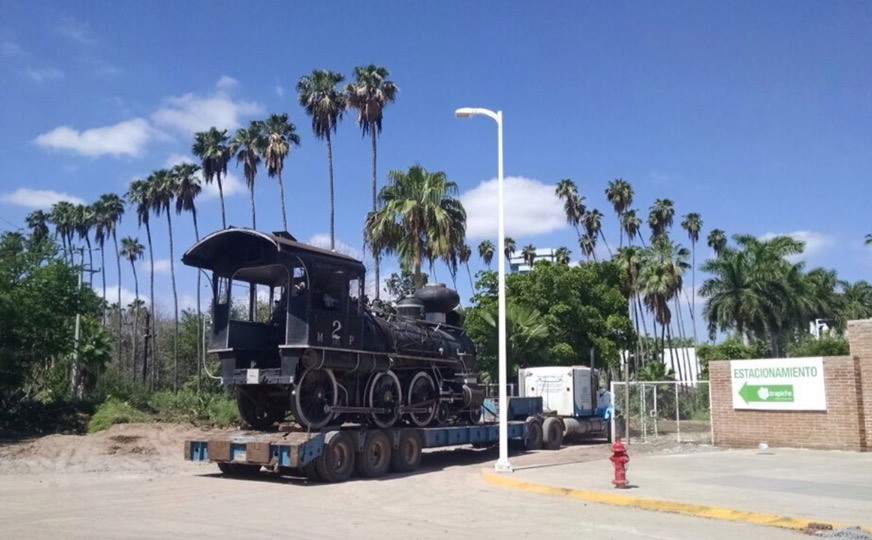

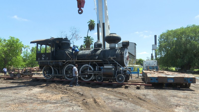

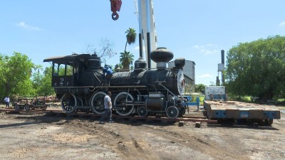

PS The locomotive was relocated within Los Mochis in 2016. Here are some pics from the old location and the move...
