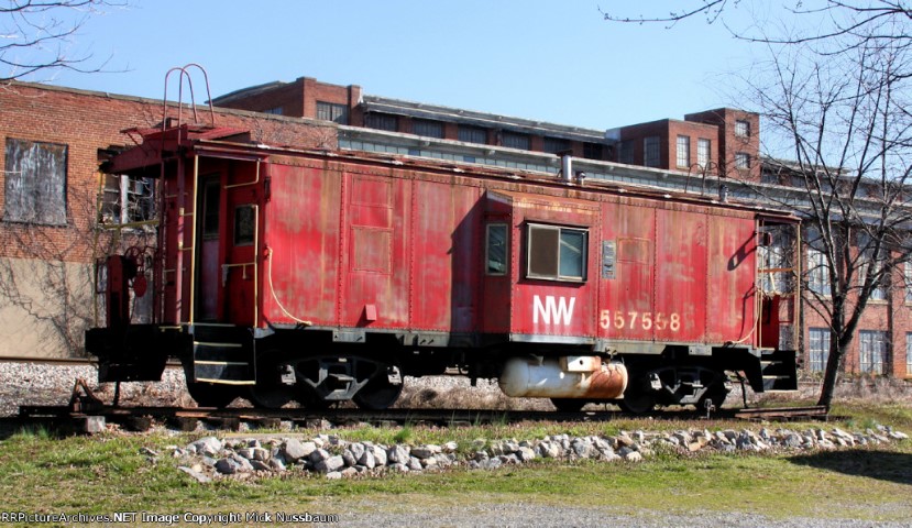

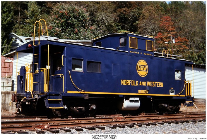

This is what I have in mind:
A large, non-removable, heavy-duty tank. Anyone have any information or recommendations?
My thought would be to contact a propane company. Dileo Gas is up near me, they might be a good source of information and usually when I have a customer with propane questions I refer them to Dileo. If I knew more about propane tanks other than it's a propane tank I could offer more. My only question is how common propane tanks like this are anymore? I don't see many trucks that come through my office that use propane for stuff on the truck itself.

The Waukesha multi bottle gas lockers were designed for bottles that would be removed from the car for filling and had to be light enough for manual handling. That doesn't make a lot of sense these days when you can get propane delivered via truck most anywhere. I second the idea that tanks rated for use on highway trailers should be good, UNLESS the FRA has a more stringent specification, which is, I think, the original question.

The propane tanks pictured provided fuel for the caboose stove and a propane-powered refrigerator. Generator was belt-driven off an axle, at least on the car I'm familiar with.

The UP had a conversion on some of there diners the was a 500gallon tank that replaced the bank of railroad grade 100# cylinders that car was built with. I have seen a couple after removal and they were very heavily constructed and by no means light.
You will need to work with your propane supplier but you will end up working with their suppliers to find a suitable tank. Don't be surprised if you strike out or at the costs for a one off custom tank.
