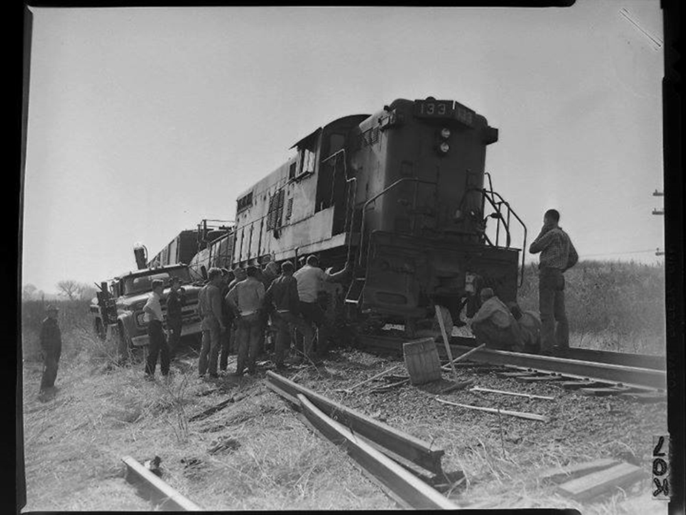

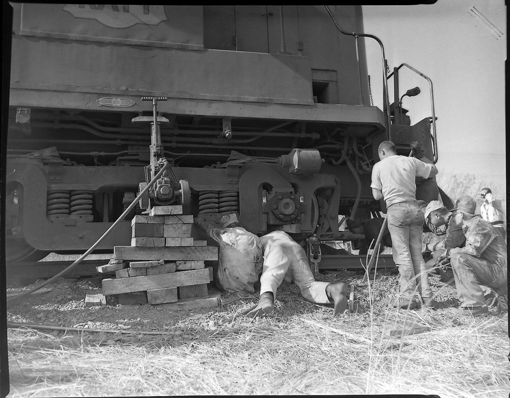

This is about 1963. Air powered "Joy" mfg. co. jack. They could use the main reservoir pressure to power them, but here they had their big truck nearby with a portable air compressor on board.
Doesn't look to be a derailment, may have been torching off a seized pinion.
