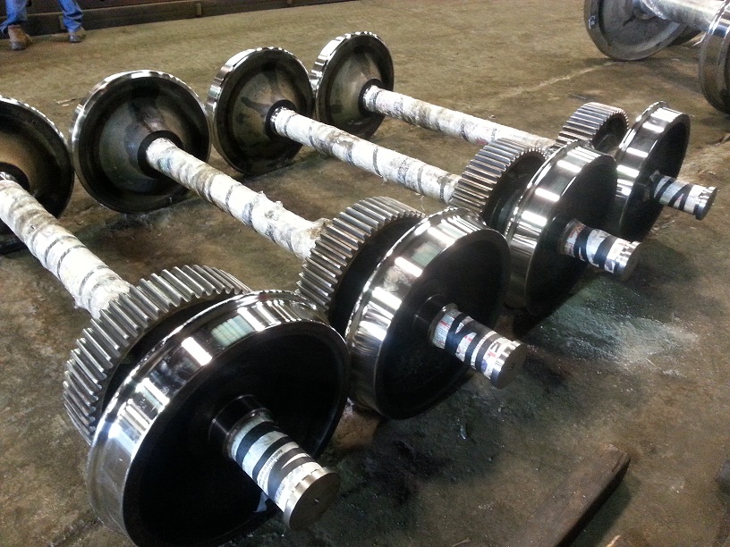

You might consider Lyons Industries, Ebensburg, PA
http://www.lyonsind.com/rail_trucks/index.html
They've done several complete trolley truck rebuilds for us. On the last project, Lyons did some pretty amazing work, especially considering the miserable shape of the old trucks we sent them. We did need to do a fair amount of "dealer prep" on the brake rigging before the trucks were ready to go back under the car, but the wheel & axle work (new axles, re-profiled wheels) was top notch.
/s/ Larry

I’ll wholeheartedly endorse Larry’s opinions on Lyons Industries.
I’ve managed six projects of varying complexity for three different organizations where Lyons was a contractor since 2005. In each case, workmanship was high quality, all matters were handled with professionalism, billing and terms were clear, and if warranty work was required, it was handled timely and completely.
Most recently, Lyons completed new gears and plain bearings for a set of 1910 vintage trucks and is completing the overhaul of a set of B2 PCC trucks, including overhaul of traction motors and Westinghouse shaft brake actuators, for a different customer.

Ditto what Matt & Larry said: Lyons. You'll be pleasantly surprised by the price and the workmanship is first rate.
