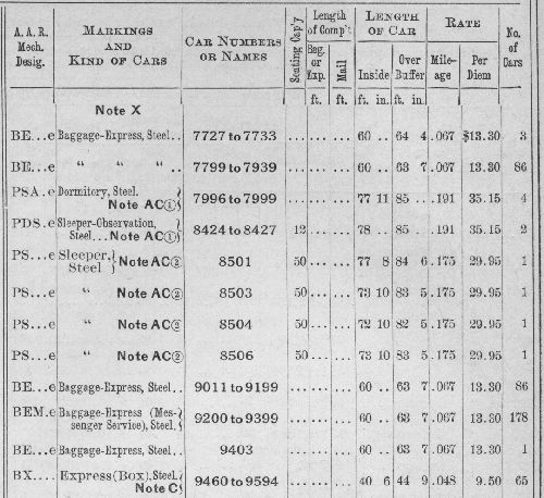

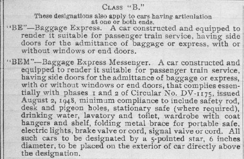

The description of the messenger facilities seemed inaccurate or insufficient. It should be listing drinking water, lavatory and toilet for the messenger. etc.
So I grabbed an issue of The Official Register of Passenger Train Equipment -- the one I pulled down from the shelf was issue of March 1964. the listing for PRR lists the car as being AAR car class BEM for Baggage Express Messenger. Elsewhere in the publication is a listing of the class definitions. Below you will find scans of both of these:
File comment: From page 78-86 of March 1964 O.R of Passenger Train Equipment

File comment: AAR classification of...passenger train cars
From page 114 of March 1964 O.R of Passenger Train Equipment

I take it "pigeon holes" means a series of cubbies, like a shoe rack? Perhaps above the desk to hold papers and whatnot?
Thanks in advance,
