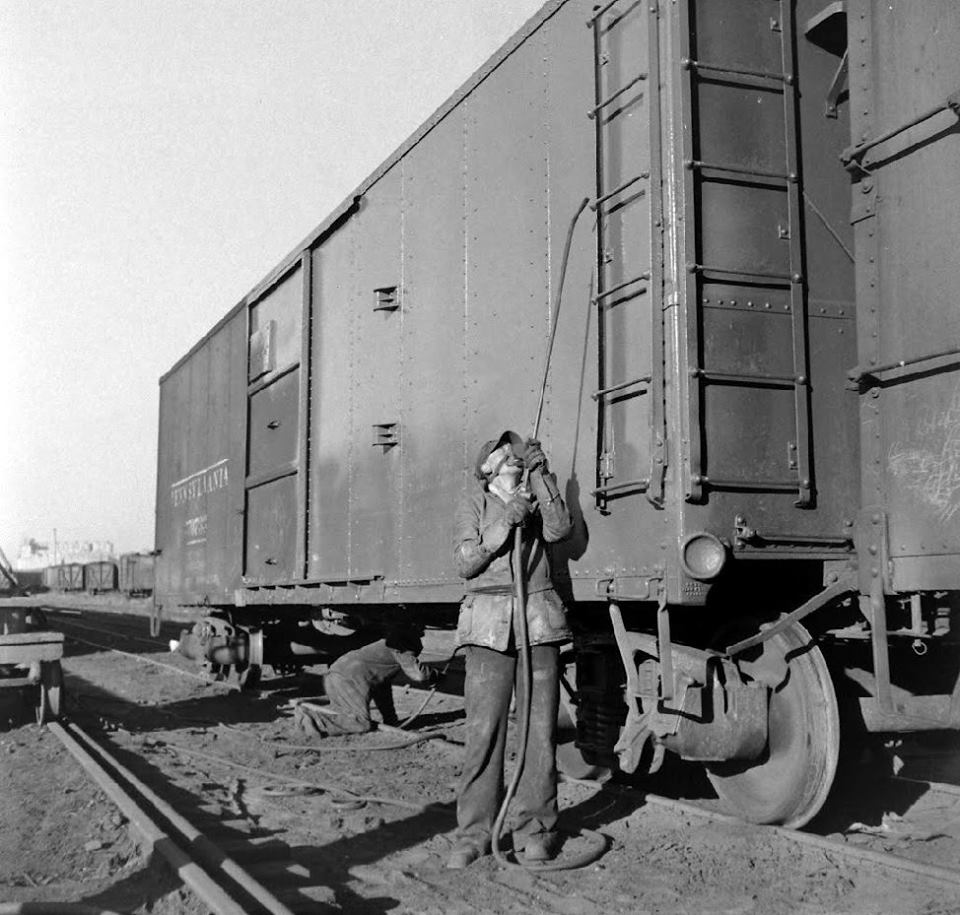

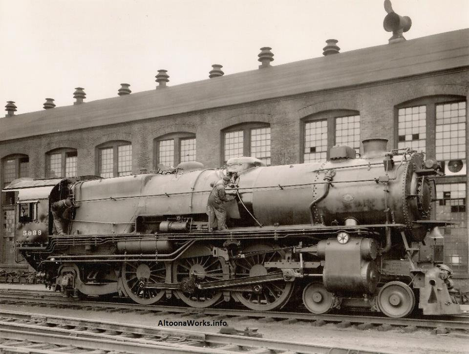

If we are to truly and accurately do it the "right" way we must look at none other than the Standard Railroad of the World! And what does the mighty Pennsy say?
Locomotive shop prefers brushes
Car department prefers crude spray rigs mounted on push carts.

I remember a reminiscence in Trains Magazine from, I think, a Milwaukee Road carman who recalled spraying freight cars in the 1930s using a flattened pipe nozzle instead of an aerosol spray gun. The Pennsy car photo may show the same sort of hose job.

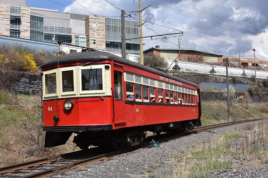

I was a house painter on my uncle's crew in my youth. We did high-end properties and always used brushes and rollers. 20 years ago, at the East Troy RR Museum, I took that experience to lead the painting of a 1927 electric trolley car. Former Philadelphia Suburban Transportation 164 was painted using an oil based primer after all the body repair and surface sanding was done. The primer was wet sanded after drying with fine grit paper and a second coat applied. The finish paint chosen was an oil-based tractor enamel from the farm implement store. Because tractors sit outside most of the time their paint needs to be durable and resistant to fading.
Application was made with fine nap rollers and and good quality paint brushes. After the first coat set up, a second one was applied. Big advantage over spraying is no masking or respirators or spray booths are necessary.
The car still looks good today as seen in this recent picture.

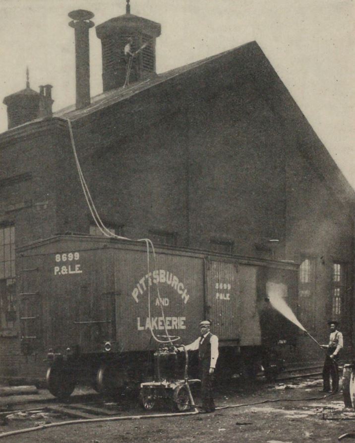

I think your time estimate is a bit off. Spray painting using steam or compressed air was actually very common by the 1890s, while the technology was being experimented with in the late 1880s. The railroad press, especially those with monthly columns dedicated to paint shops, were very interested in spray painting in the early 1890s and most issues had some new experiment from railroads showing off just how effective and cost effective steam painting was.
Attached is an image printed in the August 1898 issue of Railroad Car Journal depicting the Pittsburgh & Lake Erie steam paint setup. The article described an experiment to determine the maximum effective altitude above the ground that steam lines could atomize paint. It also indicated that the photograph was taken several years before printing.
