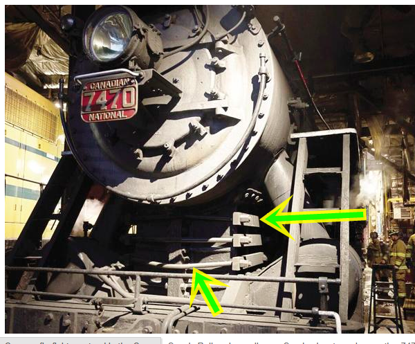

Looking close at the picture, is the object I've pointed arrows at a shop made brace to hold the two halves of the saddle casting together?
 Post subject: Re: Conway Scenic RR: Fire in the Cab of CN 7470
PostPosted: Wed Jan 05, 2022 2:04 pm
Yes, it is approved as well.
PostPosted: Wed Jan 05, 2022 3:56 pm
A crack was ground out and welded up running up and down the saddle casting and the clamps are simply reinforcements of the weld. It's been maybe 20 years ago I saw the fresh weld...... it seems to have well withstood the test of time in service since.
