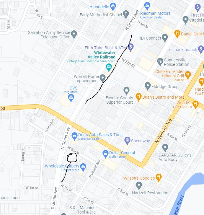

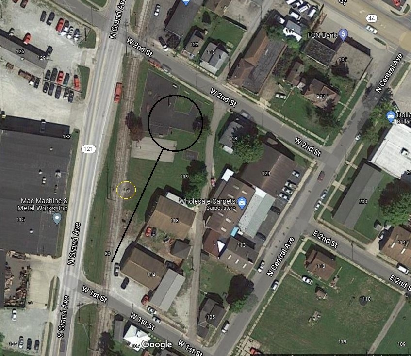

Going to see if the snapshot will attach. I crudely drew in the table and the lead in black. Also circled in yellow the existing foundation for the standpipe that used to be next to the main. The train traveled from Indy down to the river, East to CUT, then back West to Valley Junction to then go North on the Whitewater Valley branch. Some of the scenes are theare going up the Branch and then to Connersville where you see the canal to the left of the track. When the train stops in Connersville, drops passengers and then pulls North to drop the train. That is approximately where the existing WVRR station is at 4th-5th street. Then the locomotive backs South through town to get back to the Turntable. After the locomotive is turned, there is a quick shot looking back North around the right hand turn to where the earlier shot showed the locomotive backing up.
Later in the film there are shots that show Twin Arch Bridges, Chicken Farm (just North of Nulltown) and then again looking back along the train as it turns right at what we call Alpine Straight (MP63), and then a show looking North in Laurel, before the film stops.
I think it is the same film as referenced above, but here is the link to the YouTube video I am referring to: https://www.youtube.com/watch?v=vhWQIalP_rw
File comment: Connersville Turntable Site

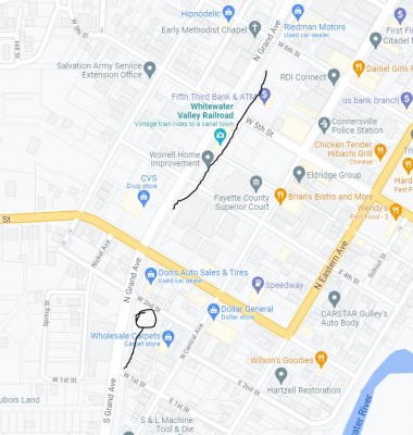

One more picture. This one is map view showing the existing WVRR station, as well as the drawn in table and the siding that shows up in the film.
The canal would have been where Grand Ave is shown on the Map, at least where it is parallel with the tracks. In our yard further South of these snips, the WVRR yard tracks sit in what used to be the canal.
The existing replacement depot is at MP 68.5 and sits near where the old Freight Depot used to be. The North end of the current WVRR railroad is at MP69, which is very close to 11th street, just North of the CSX (former B&O) bridge.
Very neat to be able to see those images from a different era.
