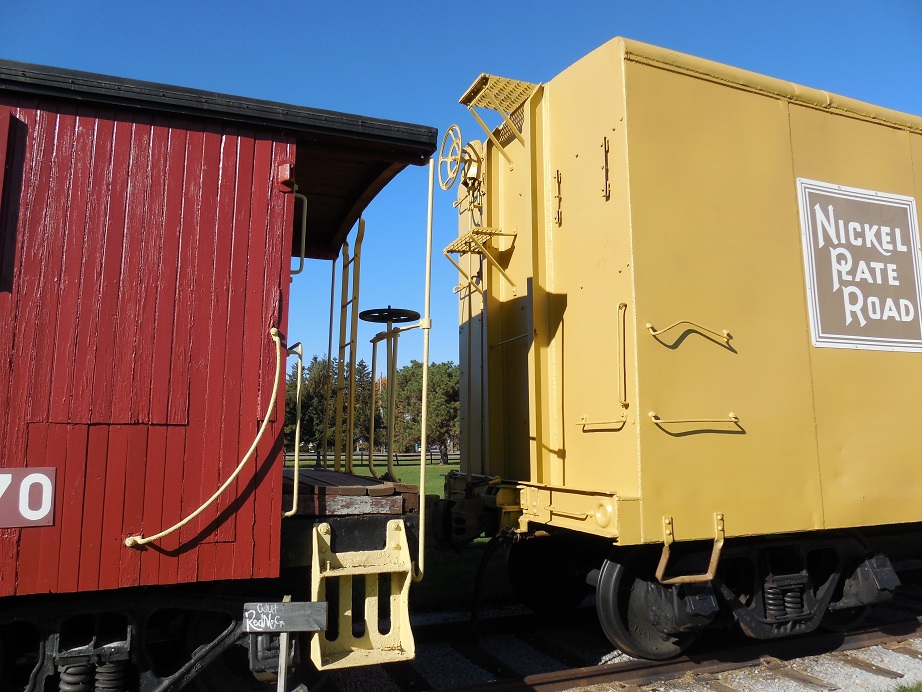

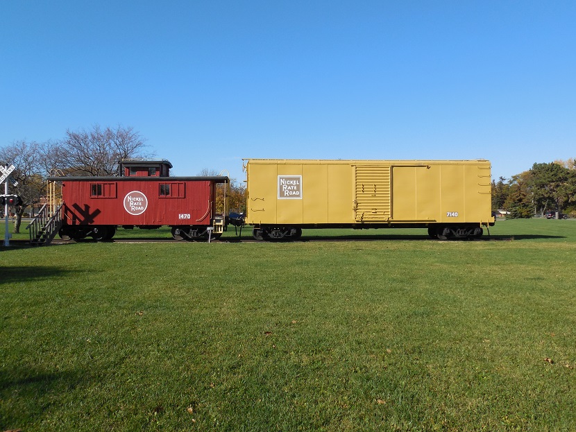

Herein are a couple of photos taken by Robert Albert back in October of 2015. These two cars are displayed with the old (1880) Toledo St. Louis & Western (Cloverleaf) Maumee depot. The caboose is identified as Nickel Plate Road but in reality it is former Chesapeake & Ohio #90695, sold to the Toledo Terminal in 1953 and numbered as TT 170. The boxcar is also identified as Nickel Plate, but that apparently isn't the case. The first photo shows what appears to be a normal 40' single door steel boxcar, but the second photo shows a rather unusual end. Anyone have any idea as to the heritage of this boxcar? Any info appreciated.

The whole construction of the boxcar is unusual... all welded, with that strange roof eave treatment. It's obviously been rebuilt from an older car. I would suspect AC&Y, only in that I'm familiar with some other cars they rebuilt, and similar flat panel and welded roof construction was used.

Circumstantial evidence: The AC&Y was affiliated with the Norfolk & Western, which owned all the track in Maumee after 1964.

With all due respect to Mr. Storzek, I would be very surprised if this was ever an AC&Y car, but I can't offer another suggestion. I suggest looking closely at the trucks for cast-in data, although it is possible that they are replacements.

The prominent end posts aren't that unusual, and don't necessarily indicate an end door. Back in the pre-WWI era, before the advent of pressed steel ends, ALL boxcars had end posts, some cars had four, others only two. The end sill protruding beyond the end is another design feature that was gone by WWI. What is particularly jarring is seeing these features on a welded car; welded construction didn't come into its own until after WWII.
Which leads me to believe that these cars are the result of covering the steel frame of a much older car with steel sheet, and it looks "home made." For a while between the wars, the Youngstown Steel Door Company marketed prefabricated steel sides for rebuilding older cars, but those sides were riveted, and the resulting cars made use of all the latest pressed steel ends and roofs.
These cars are just weird, the result of someone trying to improve their car fleet one at a time in their own shop. The question is, who?
