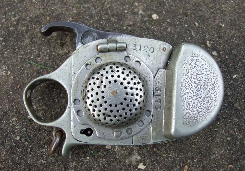

Looks as though there is a slot (to the left of the screw head) for a ticket to be inserted for punching, the punchings then collecting in the cylindrical part, at a guess.
The register would advance each time a ticket was punched.
If they were anything like the UK versions, the punchings would be checked at the end of the day to see if the revenue tallied with the tickets punched.....

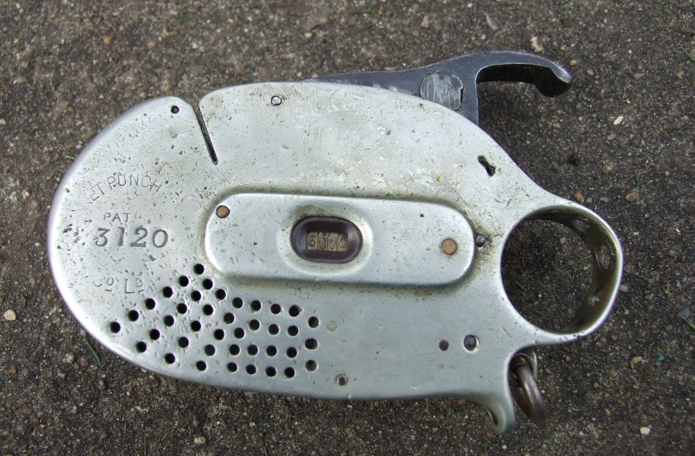

This is the one that I have, and seems a similar principle to the Washington one.
Measures roughly 5" x 3"......
Register is on the rear with rotating brass dials.
Hand grip operated punch, which sounds a bell when activated. It won't work without a ticket inserted in the slot either.
The punched parts of the tickets are collected in the raised area at the right hand end of the upper view and this is (nominally) secured by the lifting area encosing the bell, which was released by a key, presumably held back at the depot.
I found a metal box containing the remains of a number of these punches in the loft at work getting on for 40 years ago and I think, from memory, we were able to assemble 4 or 5 working examples from these parts, which explains why there are different serial numbers stamped into the punch itself and the removable punched-ticket collector lid!
