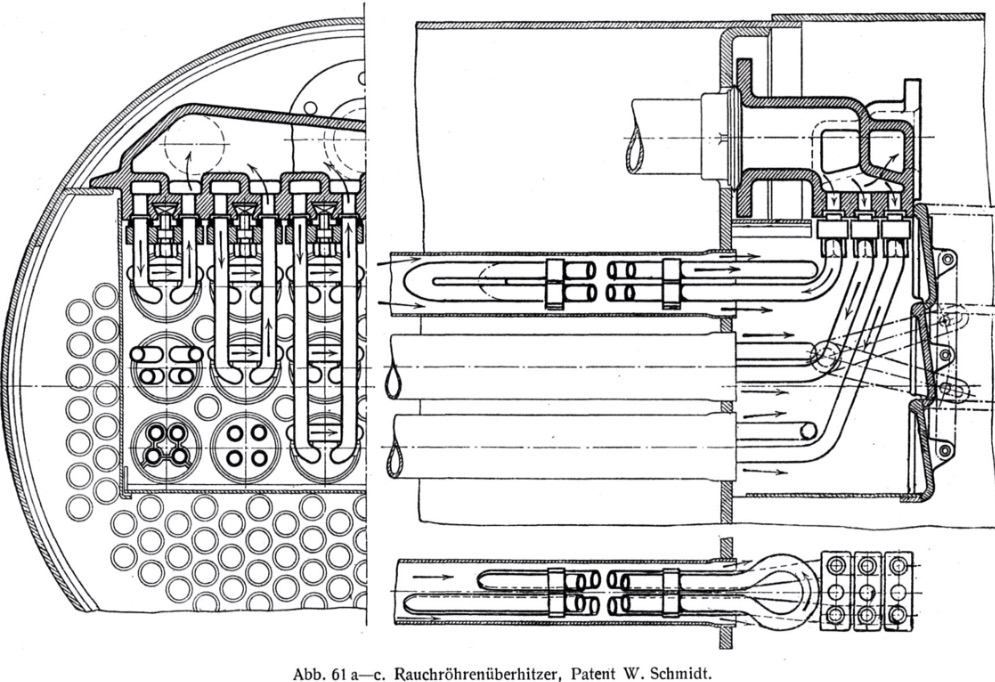

While it is hard to find reliable first hand information I myself rely on the
"Standard Publication"
"Röll:Encyclopedia of Railroading" 10 Books Germany/Austria 1912-1923
It is available online:
http://www.zeno.org/Roell-1912/
This is the most scientific compilation of railroading available at that time.
If you are a native german language speaker it is very helpful!
I try to translate the most interesting parts about A vs E superheaters.
See below the drawings from that books.
First both are German W.Schmidt inventions.
Type A is called the regular superheater and I think it is widely known how it works.

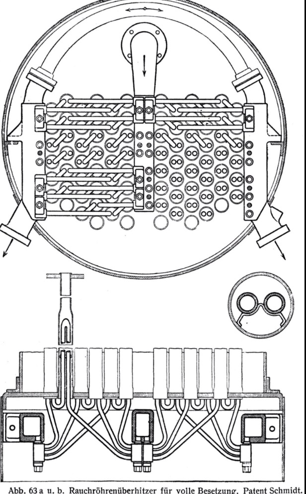

Type E is called superheater for full occupation, that is what the encyclopedia says about:
Very usefull for saturated to superheated conversions when the original tubes are 2.5" or
larger then no retubing necessary.*
No damper needed because the smaller tubes can not tansport as much heat as larger ones,
also the the danger of burning the superheater elements is diminished this way.
For new build locomotives it is recommended to use this type in small, commuter and
branch line locomotives. The ability to reach the high temperatures faster make it
favorable to switching and commuter locomotives.
Now my opinion why some american locomotives with type E overheated. The american way
to make everything bigger did not calculate the correct lenght of the superheater elements,
one feet shorter and the temperature would be excellent!

File comment: Type A
File comment: Type E
