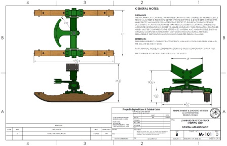

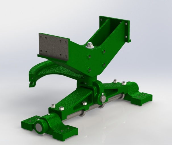

Attached is a sample rendering from a project we recently worked on for a museum. They need a set of castings for the skis for a Lombard tractor. We reverse engineered the components referencing surviving originals. We used Solidworks to model the components and develop the shop drawings. Next step, the 3D part files will be sent to the foundry where they will be used to generate 3D printed sand molds which saves a ton of money over traditional patterns and core boxes. Albeit, the 3D printed molds are a one time use.
