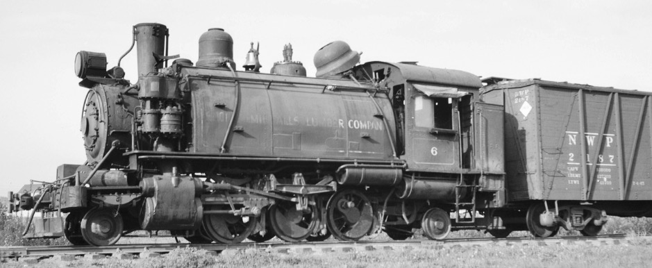

File comment: On the move to BC in 1948.
Interesting behind NWP boxcar between WA and BC.

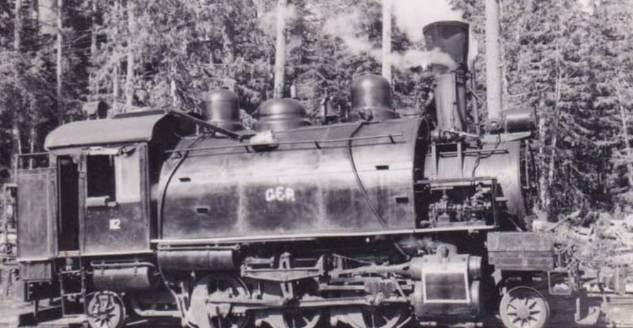

File comment: CFP #112 in the 1950/60s.

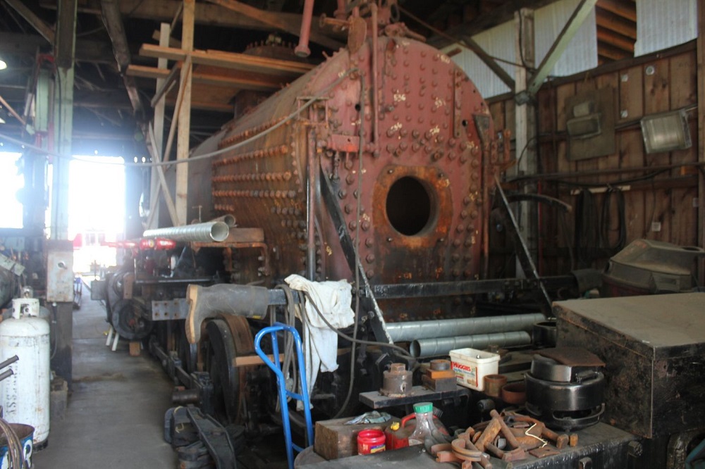

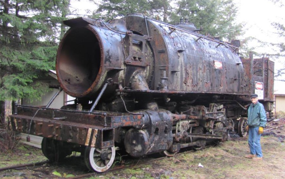

I suspect the pandemic has delayed work, as it has for so many of us. This photo was posted to their Facebook page in August 2020, with the following caption:
"The back of the firebox on the #112 steam locomotive. The #112 is still awaiting its new cab."

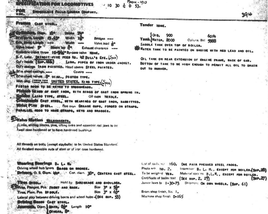

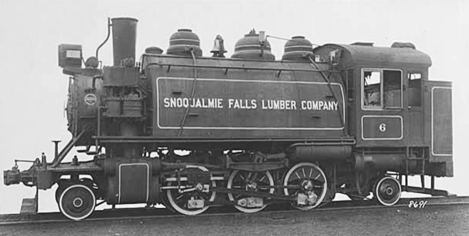

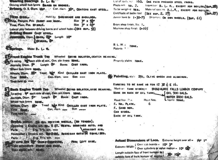

@tom

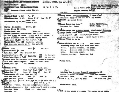

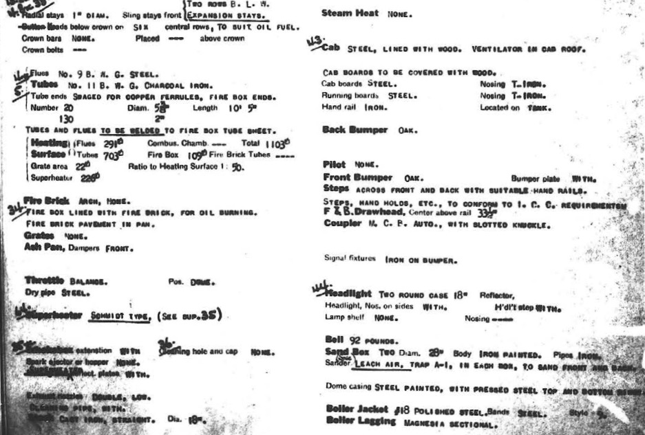

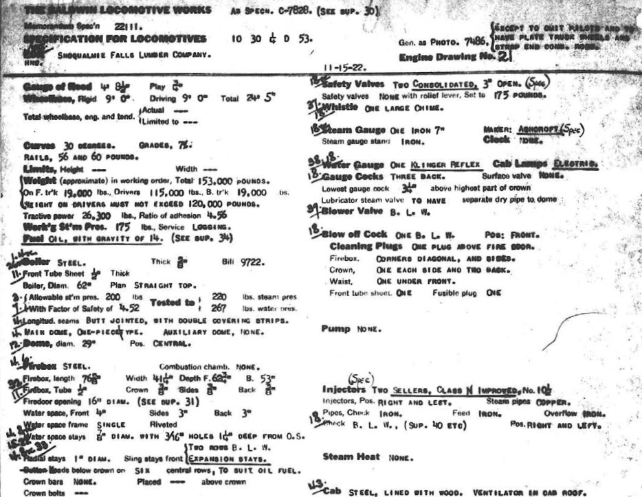

here are the Baldwin specs.
The idea about 200lbs is nice but not recommended by me. The adhesion factor in the
specs 4.56 is wrong calculated. It is real 4.37. If you up to 200lbs it will go to 3.84, more
suitable for a 1880 4-4-0 not for a logger with 7% grades.
Adding more weight for such a solution is also borderline. It is overall a very big/heavy
2-6-2T logging engine with very light rail for the axle loading.
I expect Snoqualmie Falls Lumber get exactly what they needed.

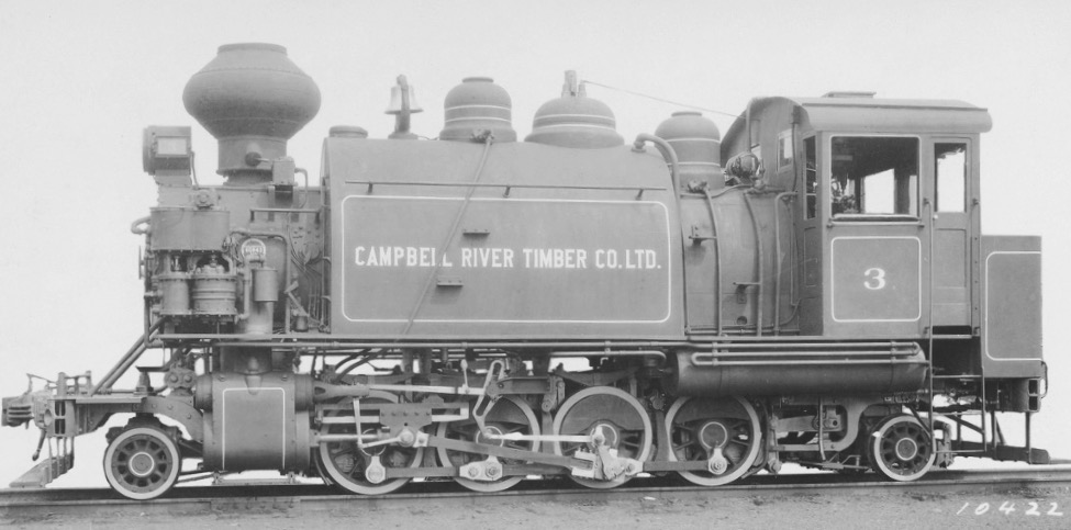

@tom
A year later ALCOs "small" 2-8-2T logger with the 18" cylinder size is available. That would
match your needs.

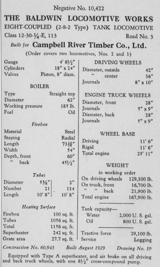

@tom
Here the specs of the other Port Alberni locomotive you mentioned.

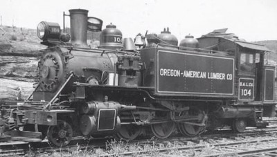

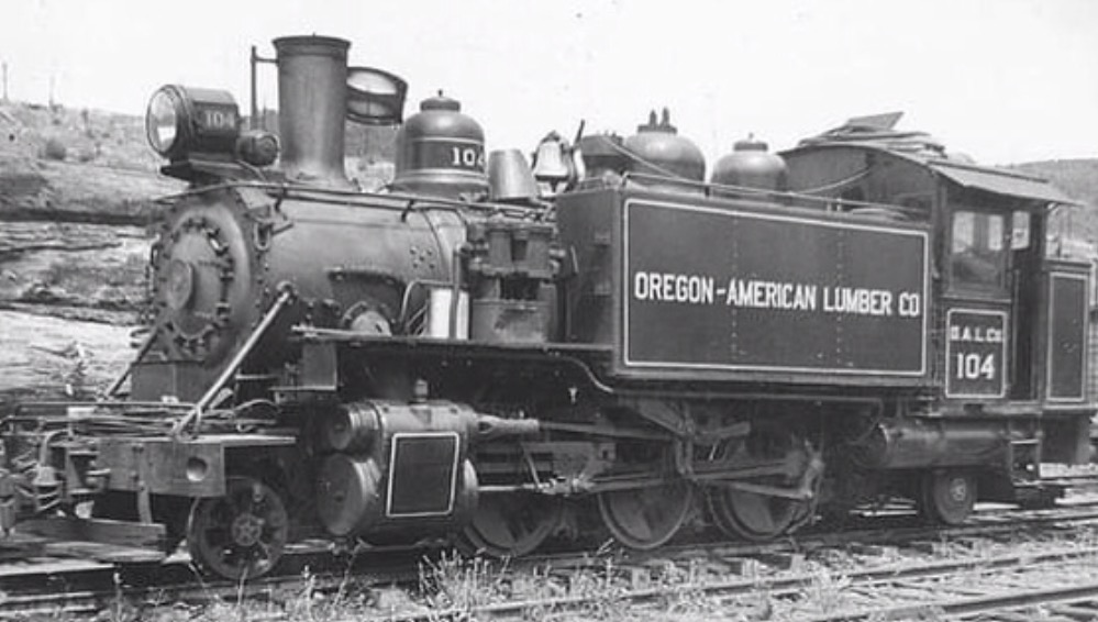

sidenote
This

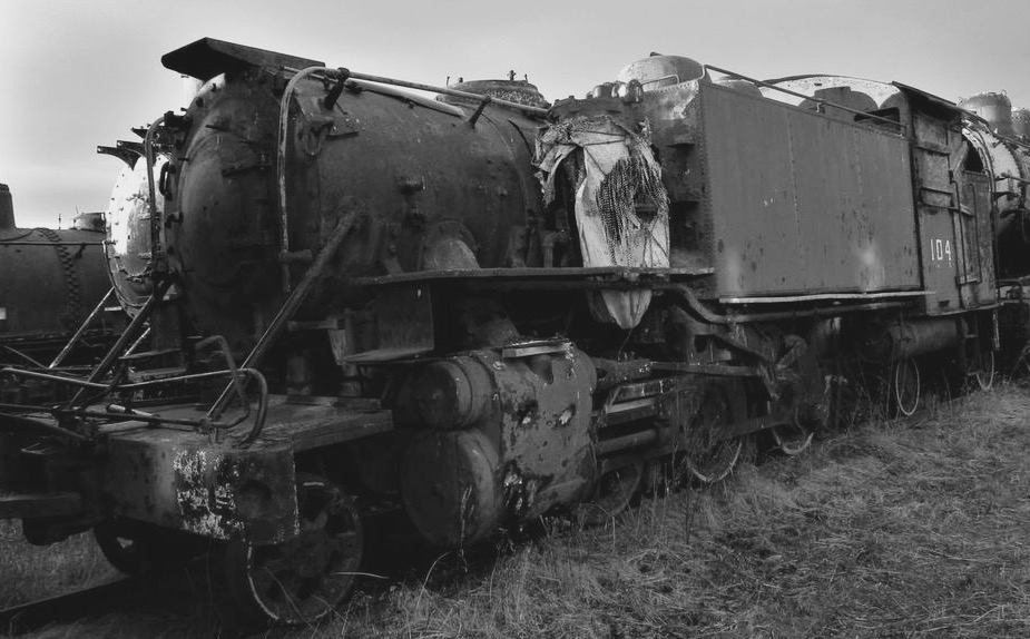

Baldwin 2-6-2T 10-30-1/4D,53 cn56323 march-1923
Snoqualmie Falls Lumber #6
and
Baldwin 2-6-2T 10-30-1/4D,54 cn56851 august-1923
Oregon-American Lumber #104
are the biggest 2-6-2T logging engines survive today. The latter a bit heavier with a
bit less TE. It will go from Merrill, OR to OCSR sometime in the future.
All other surviving "logging" 2-6-2 with 18" or bigger cylinders are tender engines.
And there are true cinderella sisters 53+54. My eyes told me 53 is a beauty and the same
time 54 is more the ugly duckling out of Baldwin family...? What you think?
File comment: Merrill, OR
