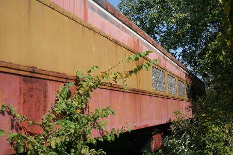

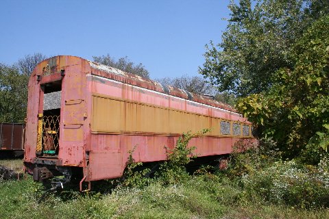

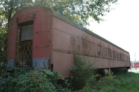

On a note regarding the Chessie Steam Special cars.... I was told the B&O car shown below last year in Huntington WV was a Chessie Steam Special car, carrying the name E.M. Frimbo... ( I was told this by someone locally in Huntington )... For those who do not know anything about E.M. Frimbo... the name pays tribute to Rogers Ernest Malcolm Whitaker (January 15, 1900 – May 11, 1981) who was an editor of The New Yorker magazine and was also known to readers for his many contributions to Talk of the Town under the pen name of E. M. Frimbo, World's Greatest Railroad Buff.
Perhaps someone can verify the use of this car... I suspect the person who shared this information with me, is a credible source of information....
