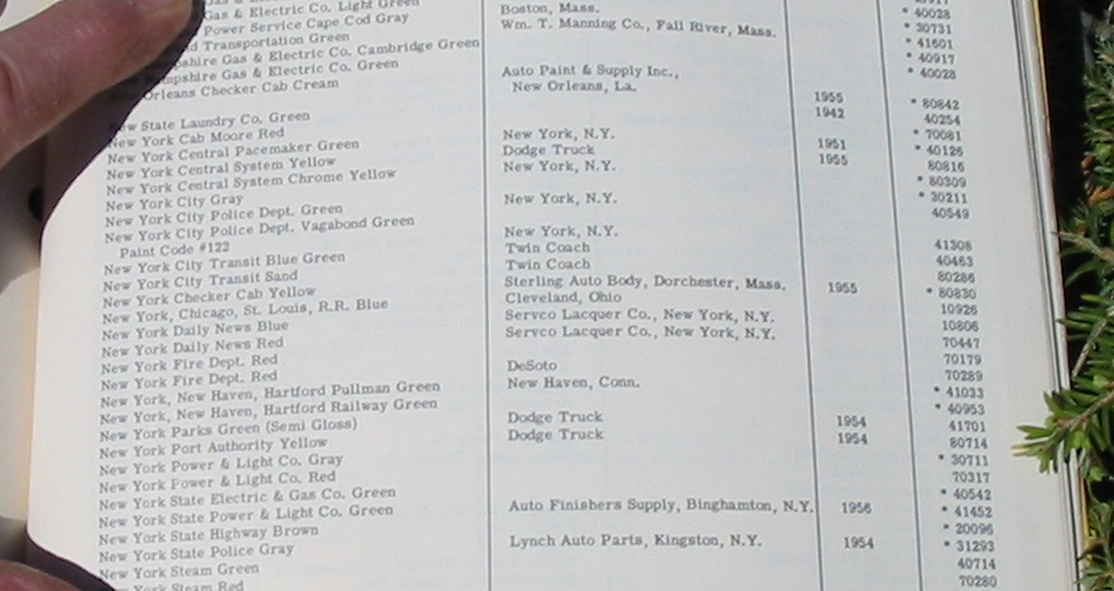

Here's what the Ditzler catalog looks like along with a photo of a portion of Form 5756, Page 35 with the entries concerning the NYC and the NH codes posted over in GTW Dude's thread. Basically a compilation of several separate forms from the early to mid-fifties, it's going to be tough to copy due to the way it is bound but we'll figure something out.

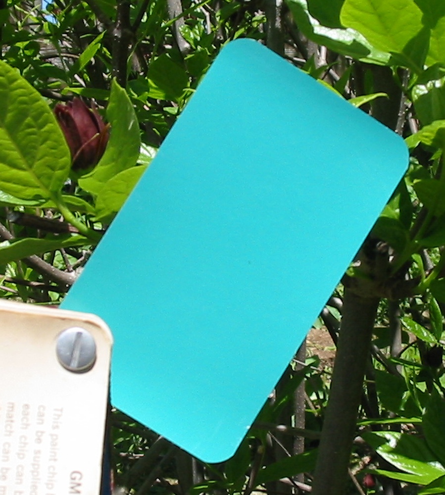

Now that I'm all straightened out on my New York Central greens, WE5687 would be the General Motors Code for Century Green...

Thank you. That’s what I mean by some form of documentation. I can add that to the cross reference.
The good-ish news is that PPG can still use that number as a close starting point. Since pigments changed away from heavy metals, the proportions of pigments will like lead to slightly different results so a comparative sample will be needed for an exact match.

After looking around a bit, NYC Pacemaker Green appears to be very similar to the Canadian National's olive green which, in turn, appears to be very similar to Bell Telephone Green but I'll save that sort of speculation for my Reading thread.
BTW, there's a New, York, Chicago, St. Louis R.R. Blue listing in that picture also, 10926.
