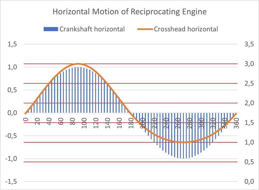

Here is a graph that shows what Kelly is saying.
Zero is rods up. Ninety is front dead center. Stroke is 2, and main rod is 2 long. There is much more swept cylinder volume on the forward half of the rotation, than in the rear half of the rotation. Measurements are with respect to wheel center.

And, unless you have tail rods, the front of the cylinder has more expanding steam volume than the rear half thanks to the piston rod's occupying space. There's a whole lot happening at the same time. I think the traditional way to set valves is the standard because it is simple and achievable and makes the sound seem right.......
