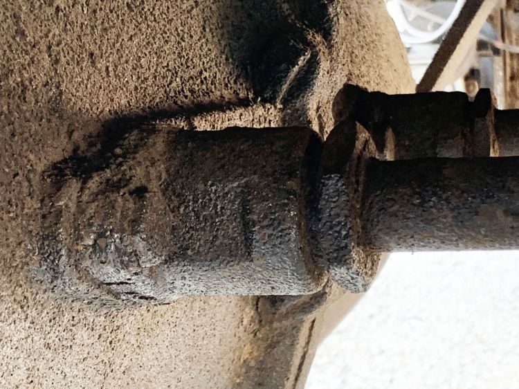

Here's the fitting. What is it and is it replaceable?
 Post subject: Re: Brake Pipe Fittings Question
PostPosted: Mon Jul 11, 2022 5:18 pm
Not Dresser fittings. Looks very much like WABCOSEAL (WABCOTITE may be a similar arrangement). That looks pretty crusty. You might want to consider new flanged fittings and a new piece of pipe. Another method would be a hose assembly from Strato, with the right flanges on each end.

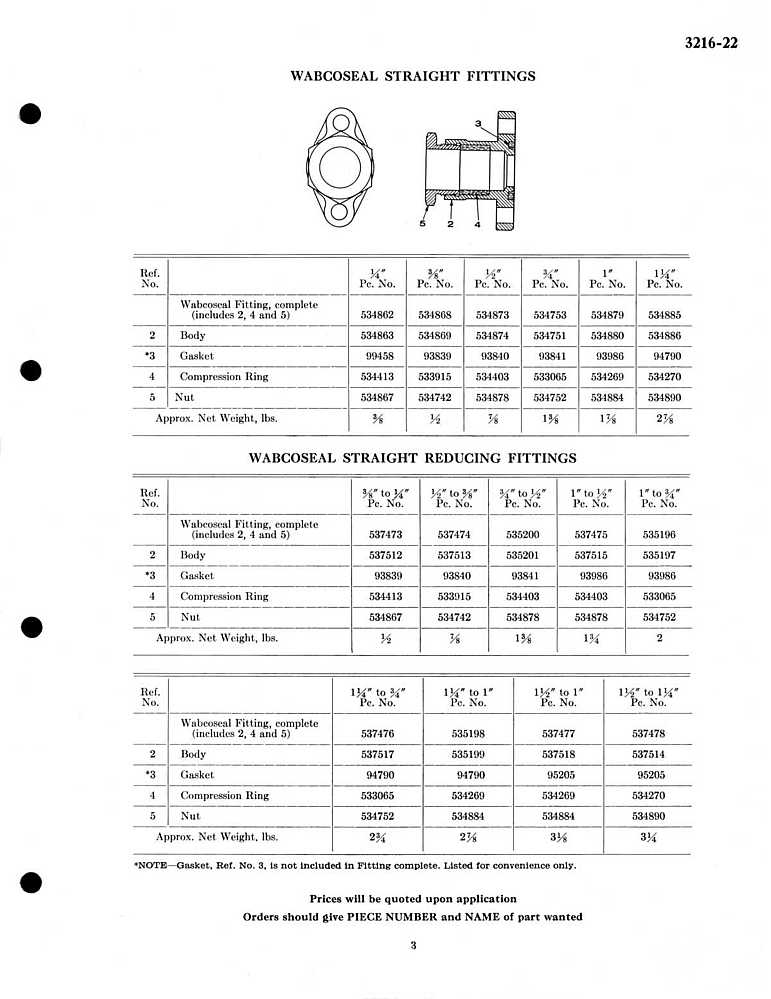

WABCOSEAL, see attached. You will need items 3 and 4 (for 1/2" pipe), which are probably still available from WABCo (in its current iteration). The parts catalogue doesn't list the material, nor does the piece number record. However, these are both probably "rubber goods" (WABCo's term), particularly item 3, and given the age they most likely aren't the white dot formula, which means they will stick to the metal upon disassembly.
If you install new pipes, make sure they have bends like the original (i.e. no pipe elbows). Soaking the threads in turpentine or ATF for a month is advisable before attempting disassembly.

MT4351 - Many thanks for the chart.
Thinking ahead and considering my luck on this car, the fitting body and nut might be be too corroded to be reused. Is there an alternative that can be used or would I be looking at having new lines fabricated?
PostPosted: Tue Jul 12, 2022 1:31 pm
Joined: Fri Aug 27, 2004 2:13 am
Posts: 58
Soak the threads repeatedly over about a month in a penetrant (turpentine, ATF, Cyclo Breakaway, Kroil, LPS1, but not WD-40, which is junk). If you can undo the cap screws in the flanges at each end (pipe bracket and reservoir), grip the hex nut holding the pipe in a vise and use an open end wrench on the flats of the body (it's what they there for). Work things back and forth, gradually unscrewing, rather than all at once. Tapping on the fitting's body with a hammer (but don't beat on it) while trying to loosen might help breaking things loose. If you use an impact wrench (on the bolts), pull the trigger in very short, brief bursts, pausing at least five seconds between burst otherwise the threads will overheat, gall, seize up, and you'll never get things apart.
