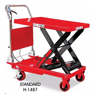

A scissor-lift table makes lifting the brake head + piston + cup assembly a lot easier and safer when working underneath a railroad car. Up/down is under your control using the manually-operated hydraulic pump.
For Niles Canyon Railway, I purchased a sturdy made-in-USA scissor-lift table from a local Craigslist ad. Facebook Marketplace is also a good place to look.
