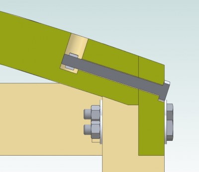

Further investigation of the way Climax Mfg. Co. secured the roof arches has revealed that they used a simple 1/2" Square Nut dropped into a 7/8" drilled hole to secure the 1/2" bolts securing the Side Facia to the Roof Arches - Not a 7/8" rod drilled and tapped for a 1/2" bolt as I initially thought. Just goes to show two things. Just because something appears to be the way things were done a 120 years ago, one (me) maybe wrong. And the second is that Climax Mfg. Co. did things the simple, easiest and cheapest way.
See illustrations below:

Further investigation of the way Climax Mfg. Co. secured the roof arches has revealed that they used a simple 1/2" Square Nut dropped into a 7/8" drilled hole to secured the 1/2" bolts securing the Side Facia to the Roof Arches - Not a 7/8" rod drilled and tapped for a 1/2" bolt as I initially thought. Just goes to show two things. Just because something appears to be the way things were done a 120 years ago, one (me) maybe wrong. And the second is that Climax Mfg. Co. did the the simplest, easiest. cheapest way.
This is fascinating. It's essentially the epitome of the KISS method.
