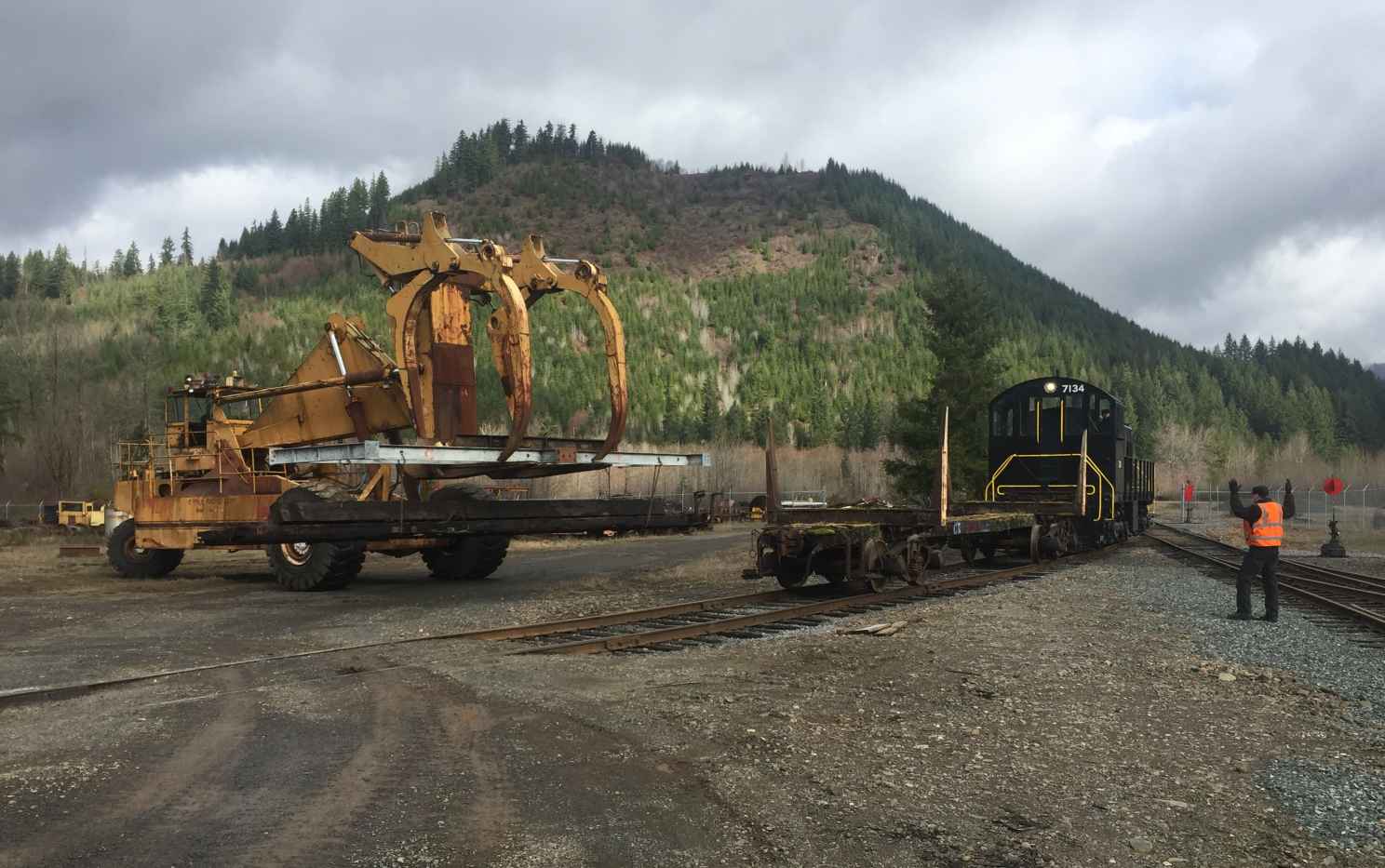

The first skeleton log car with the Pressed Steel Co. archbar trucks, I'm told, came from a private owner at Snoqualmie. I do not know the heritage of the car. The other three skeleton log cars, however, are certainly not Simpson cars. They are ex-Chehalis Western cars that were privately owned at the Mt. Rainier Railroad & Logging Museum. We loaded them with our ex-Murray Pacific Wagner "Lumberjack" log stacker. In the attached photo, I'm loading a log car wood center beam onto one of the log cars, prior to loading the whole thing onto a truck.

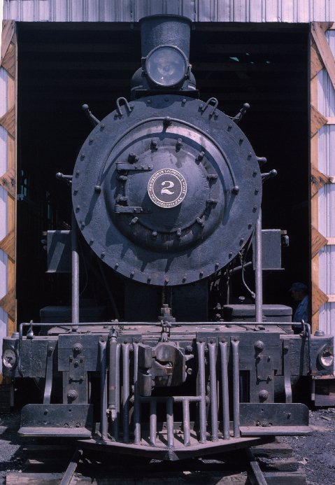

Polson #2 of my youth. . . Lake City, MI, ca. 1968-70
Steve
