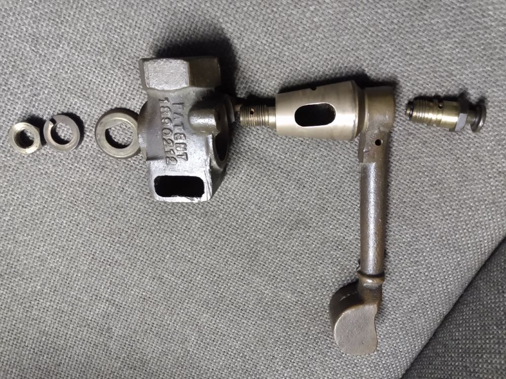

Exploded View

Thanks for the tips, gentlemen. The pic with the disassembled whistle answered my question. I now know that the hex nut on the button side is in fact a separate piece. I'll have to work on it.
Thanks again for all the replies.

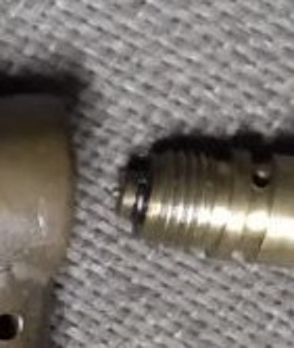

Is the hex nut surrounding the button shaft, an actual separate hex nut, or is it part of the casting? It would seem to me that it should be an actual hex nut, in order to access the air valve. However, I didn't want to force it for fear of breaking the casting.
The hex is not a nut, but is connected to a sleeve that contains the spring for the push button. The fault that we have found on many of these is the tiny oring at the inner part of the button shaft. This is what seals the air for the whistle. If that oring is split or missing, the air leaks out around the button shaft
