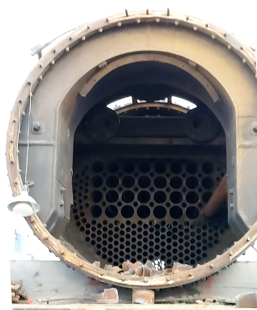

File comment: Finally, the old tubes and flues are being pulled. Once this work is completed, the boiler interior and exterior will be needle scaled for U/T testing.

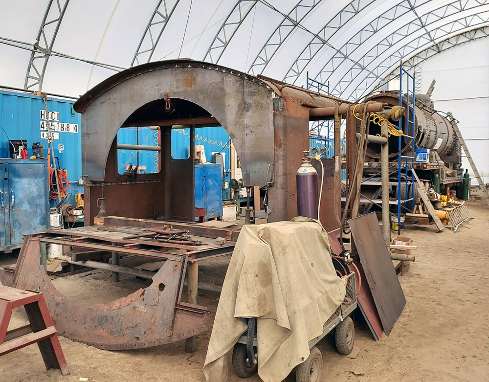

File comment: New steel now supports the original cab roof. New wood frame members and lining has been cut and prepared for installation, once the remaining riveting and welding are completed.

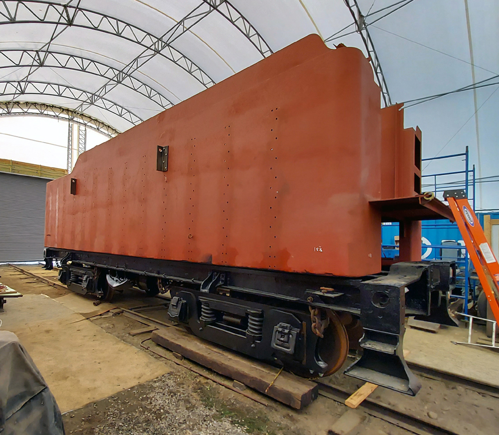

File comment: Critical note here is the original frame was completely restored with some remedial repairs. The brake lines are all new and with a few rebuilt components. The trucks have been been restored to almost new condition. This has been a true labor of love for over a score of dedicated volunteers over the past four years.

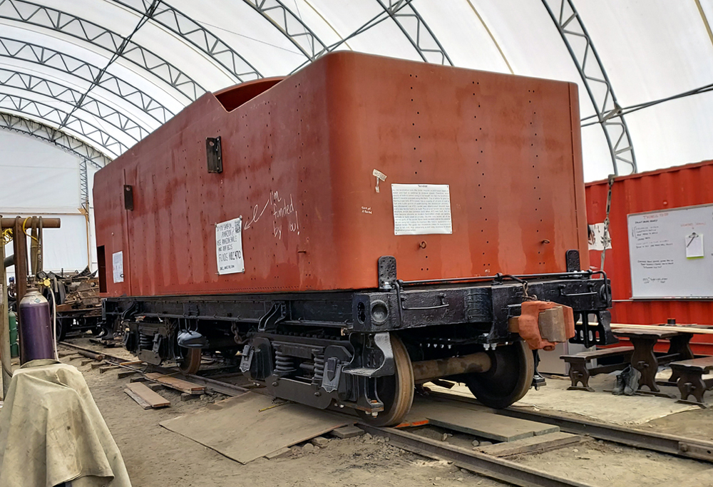

File comment: The new tender tank is an almost identical copy of the rusted out original.

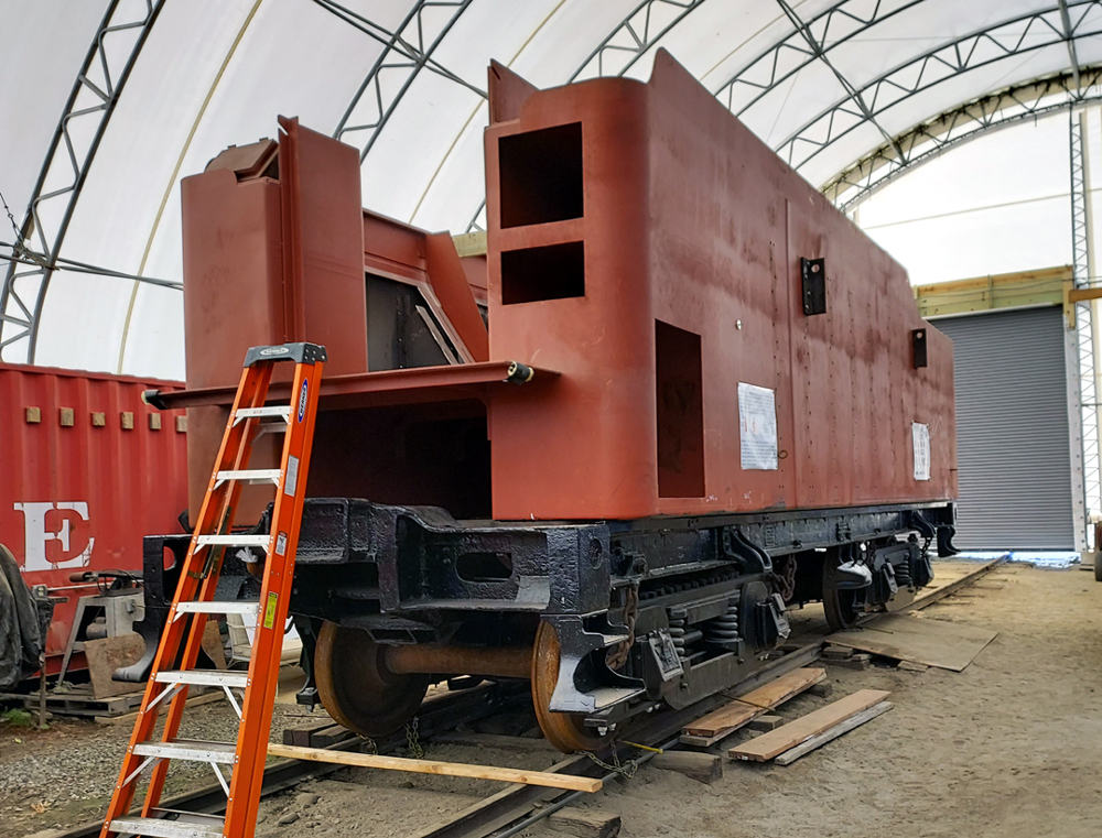

File comment: New tank set upon the restored tender frame.

How do you get tubes in and out past that water heater?
 Post subject: Re: Maine Central 470 and New England Steam Corp!
PostPosted: Sun Nov 20, 2022 3:17 pm
Posts: 110
You don't….. have to be pulled back and passed thru a clear hole. The feedwater heater is an obstruction for a few chores. It has been badly damaged from freezing when water entered during the many years on display. New England Steam will be removing the feedwater heater from the smokebox in the near future. There are currently plans not to use it or the turbo pump.
PostPosted: Sun Nov 20, 2022 10:23 pm
If that's a Coffin FWH, remember the company is still in business and overhauled the FWH for B&M 3713. It wasn't free but they saved $$$ by doing it on a "time available" basis.
https://coffinpump.com/
PostPosted: Mon Nov 21, 2022 10:47 am
The line where the locomotive will chiefly operate is short enough that the feedwater heater will not be essential. It should be pointed out, the feedwater was added in the 1940's as part of a comparative test. A Worthington was placed on 469 and data was taken as a preparation for the next generation of MEC steam locomotives. Sadly the E7A was introduced in 1947, and the data became moot.
When restored to service, the 470 will likely be configured as it was during its prime express service years of 1924 - 1942.
