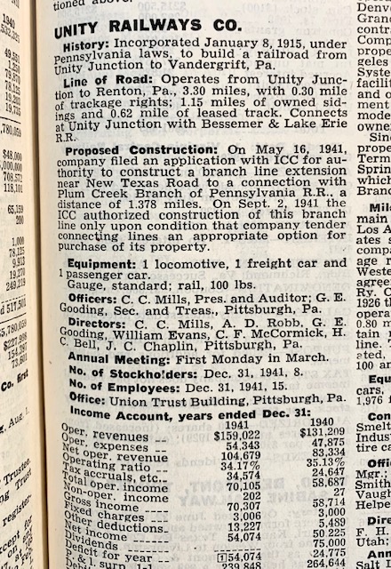

Morning Sun Books "Pennsylvania Short Lines in Color - Volume Two" by Gary R. Carlson has a couple of pages on the Unity Railways.
Moody's Manual for 1942 shows the Unity owning one locomotive, one freight car, and one passenger car. The railroad served a mine and was controlled by the coal company through a wholly-owned subsidiary.
- Alan Maples

Nice operating ratio!! 35%
