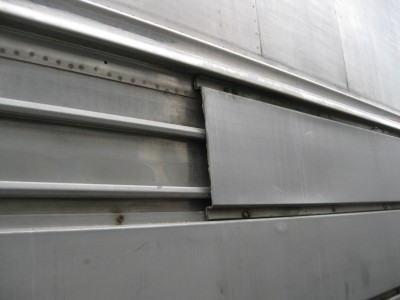

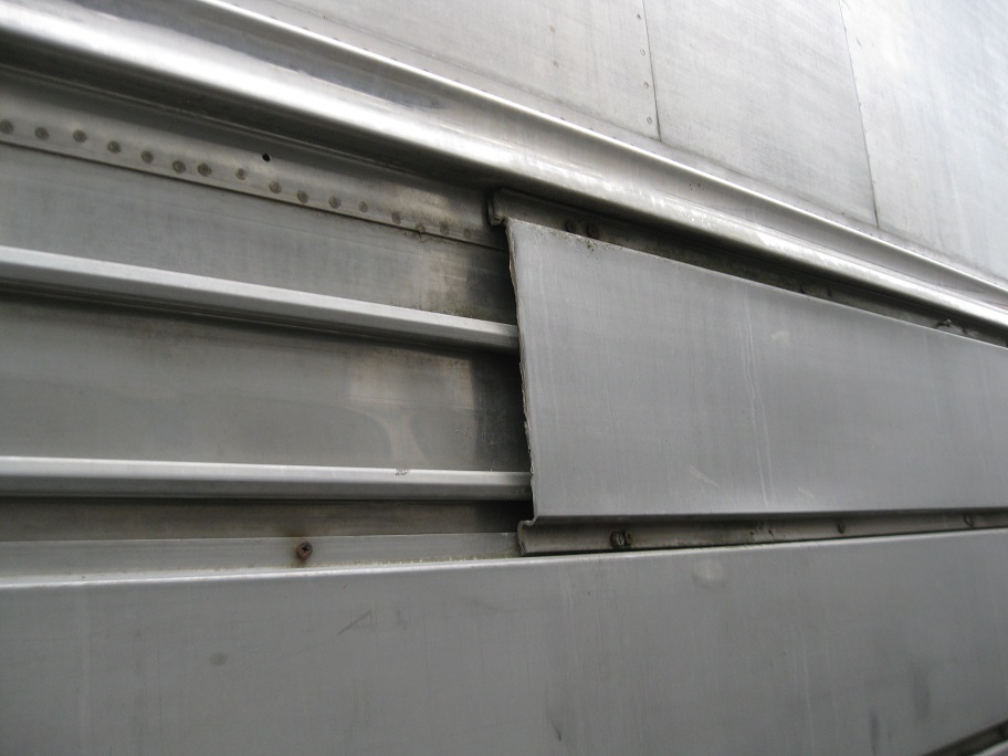

Click on photos below for larger picture.
File comment: NP dome coach showing how the flat panels ("flatting" instead of fluting?) of Budd girder frame smooth-side cars were screwed (not riveted) into place over a very similar girder sheet that the later post-war fluted cars had.
File comment: Slumbercoach showing how the flutes themselves are slid into place in the girder sheet (no rivets or screws needed), which is integral to the car structure.

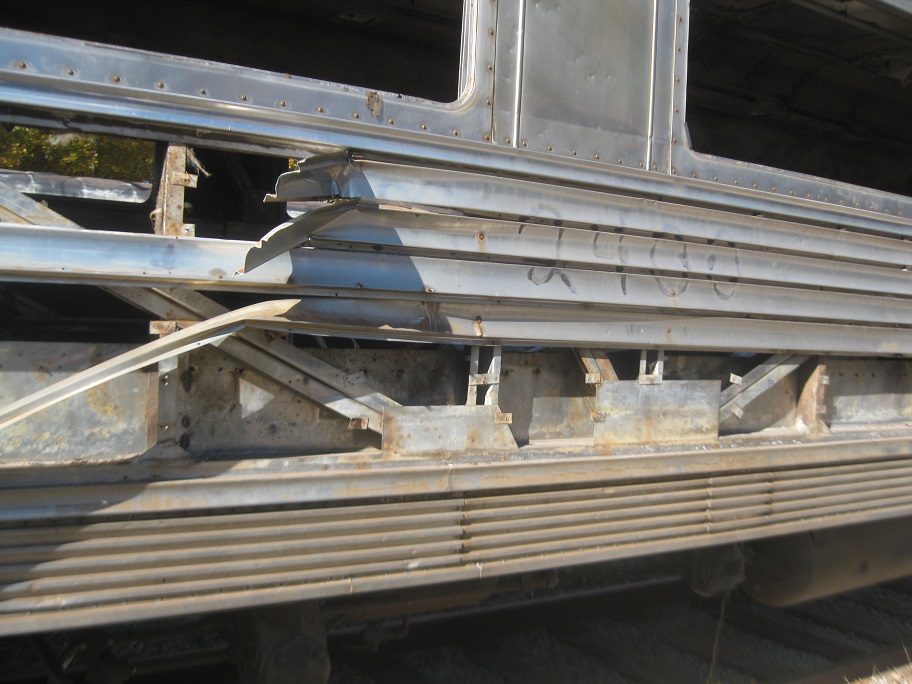

File comment: Budd 1937 coach being scrapped, showing the fluting applied over the truss-frame car structure

Thanks for those images. The car I’m working on is 1939 vintage and matches the image of the 1937 car being scrapped.
I very well could be repairing a section that had been redone previously. I do note that not one screw has been seen and I’m redoing half of the side of the car. I’m using 3/16” diameter rivets and they’re working well.
