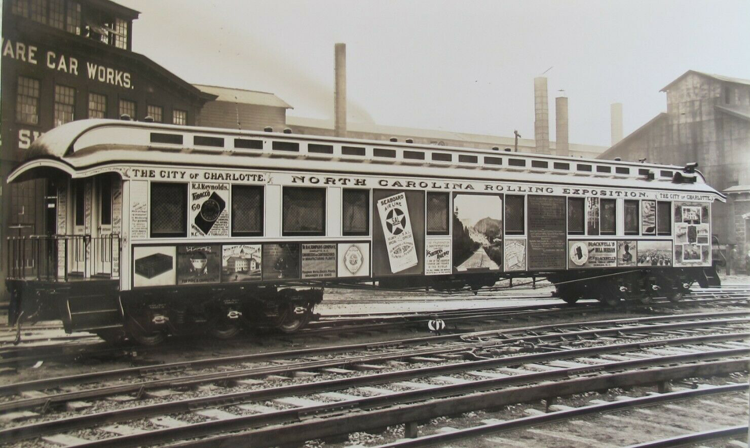

I presume that in the case of fresco painters they are the folks painting these sort of things. I can't imagine that there were enough advertising cars being built but perhaps there were.

Tom, by definition 'fresco' means painting on 'fresh' plaster.
Those advertising cars were likely pasted-on "bills" or what we'd call posters. As in the signs "post no bills".
