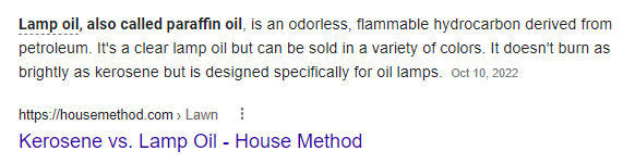

"Lamp oil" that you/I can buy at the hardware store... like what I buy to put in those old fashion (high dollar, too) "Aladdin" lamps... it's paraffin oil.

Water-White Kerosene, Long-Time Burning Signal Oil, Mineral Seal Oil and 300-Degree Oil are all paraffin derived. As far as I can decipher, Long-Time Burning is a more refined version of Water-White Kerosene. MSO and 300 Deg oils were used almost exclusively for passenger car lighting. They wanted the best light while reducing odor and smoke but were not going to spend the higher price for burning in lanterns, semaphores or headlights. At least one current supplier of MSO describes it as "Water White". Is that the same as W-W Kerosene? I have no idea. Here is a link to an NBS publication in which many railroads state the standards they use. To find the actual text of individual railroad standards may take some digging.
