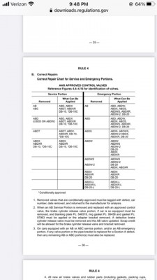

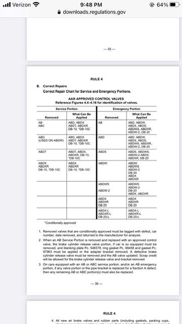

Figured I’d share this here.
 Post subject: Re: ABD Brake Valve Stud length
PostPosted: Fri Dec 16, 2022 9:57 pm
Posts: 2074
Ah, yes. AAR Field Manual, Rule 4.
Thank you.
