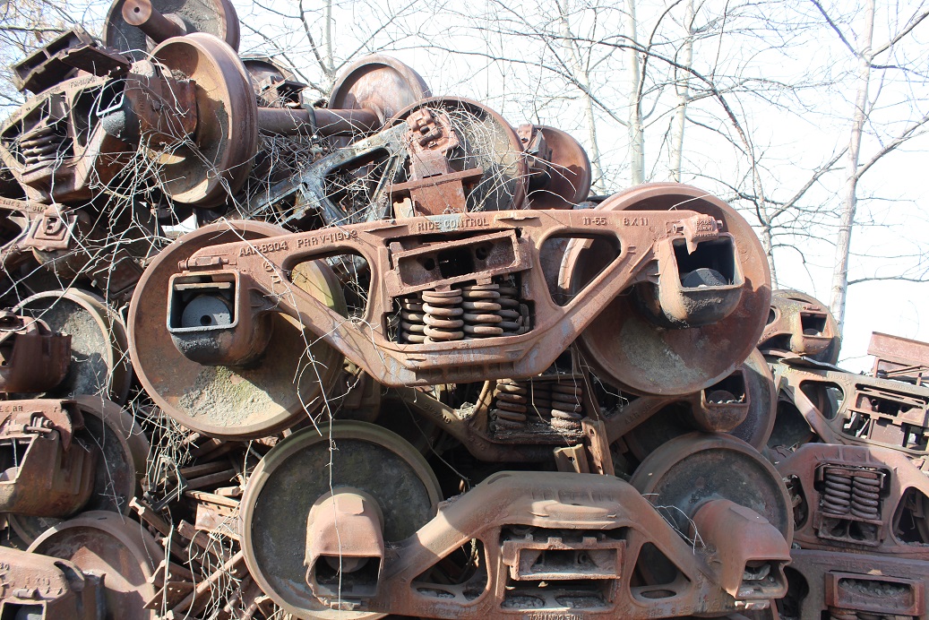

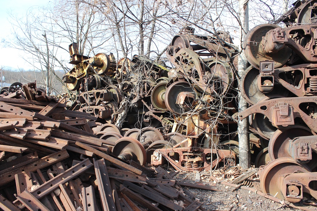

Kovalchick has a small mountain of plain bearing trucks at their yard in Burnham, PA. An option if looking for period correct trucks.

In the pictures of the truck piles, you might note the pictures have at least three trucks with separable Axel boxes which could be reused on a replica project...
The truck under the yellow one on top of the pile definitely is one...
