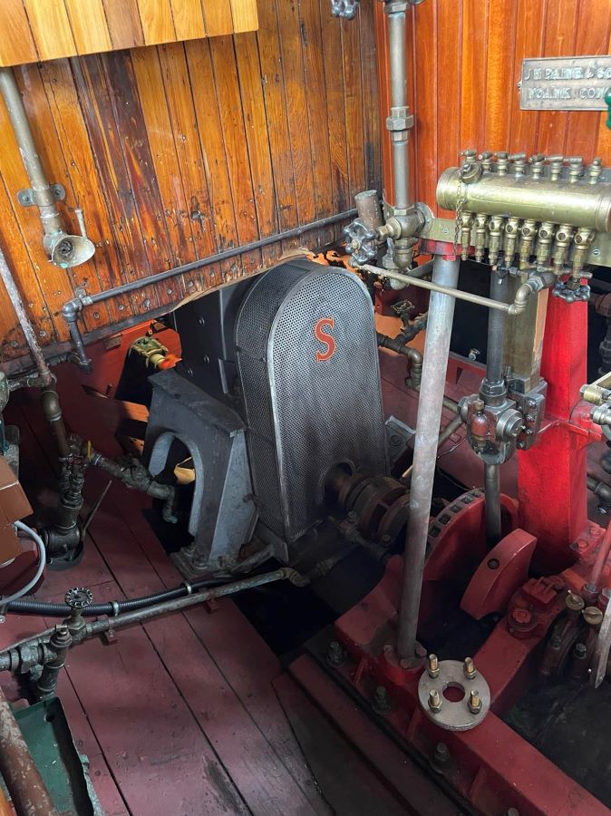

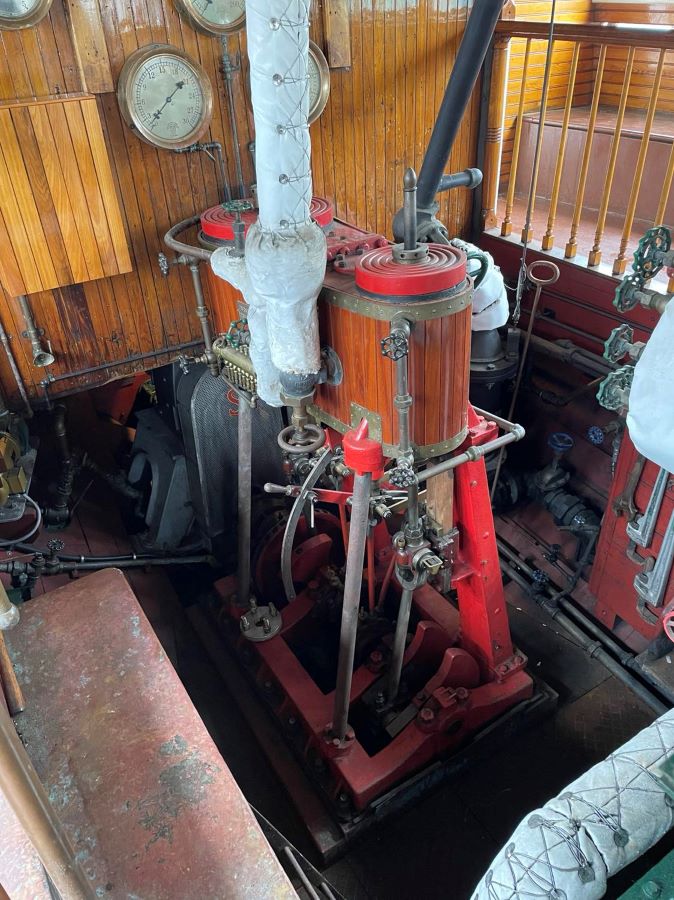

I am visiting Connecticut and am shocked to report that coastal ferry Sabino has been converted to diesel electric power. The work was done over the 2022-2023 winter. A Google search brings up articles and news items. The argument from the administration is that they could not find qualified engineers to work the engines.
I rode the short excursion today. The boat has been fitted with two electric generators. The propellor shaft has been disconnected/cut behind the thrust bearing on the engine. An electric motor has been fitted to a welded frame over the shaft with a chain (or belt?) drive to the shaft. All control is from the pilot house, and there is no one on duty in the engine spaces. On my ride, only one generator was running (I could see the control panels in the pilothouse) and it appears that the second generator is for backup.
According to the press releases, the steam plant is still present and usable for "special occassions". I saw a new coupling spacer that potentially could be used to couple the engine to the propellor shaft again. However, I see no evidence that the steam plant was being conserved. Rust was apparent on the engine, and there was no evidence of protective grease.
This is a sad example of how we can lose something that we thought was preserved "forever". Even something that was a key storytelling experience at a wealthy and well funded institution like Mystic Seaport, can be lost if there is no support group or clear mission statement binding the object to the institution.
I think the "special occassions" argument is fallacious. How can you keep the support resources available to operate a steam plant 1-2 times a year? How can you justify the inspection and maintenance expenses? If you can't find skilled labor for a daily operation, how are you going to find and train labor for 1-2 operations a year?

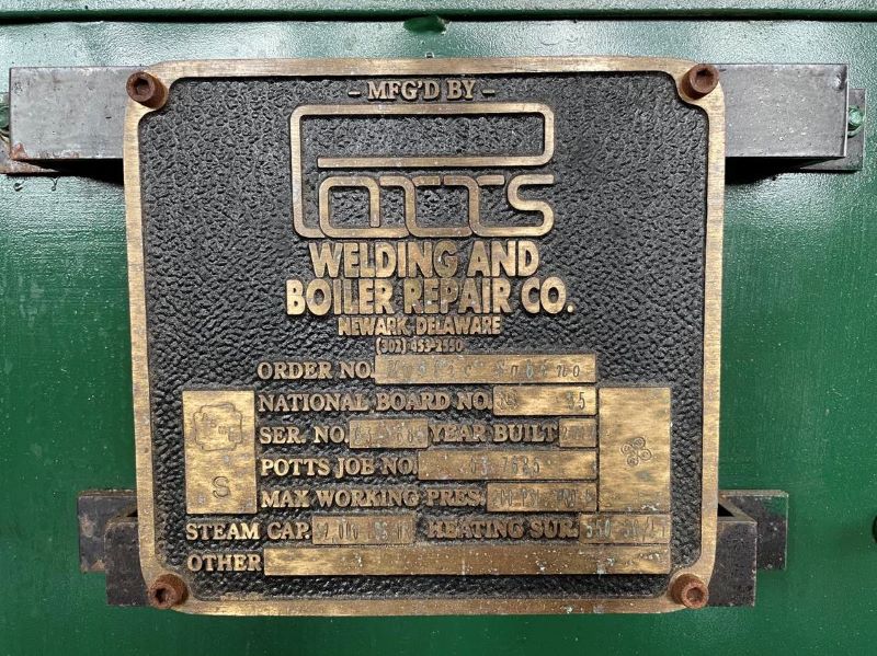

Even more shocking - Sabino received a new boiler in 2017.

That 'skilled labor' issue had been around the marine side of preservation for some time, especially with regard to a steam plant. My son and I visited the Liberty ship John W. Brown nearly twenty years ago. The gent giving us the engine room tour mentioned that it was getting hard to find steam licensed marine engineers. The engineer on duty that day- they were under steam at the pier- was in his eighties! Again, twenty years ago, and with the world's shipping going to diesel increasingly, it's only going to get worse.
It does sound like the diesel-electric conversion is not irreversible. Putting protective grease on the engine, barring it over from time to time, and keeping the boiler and feedwater system dry should help with bringing the steam plant 'out of hibernation' if qualified engineering personnel are ever found.

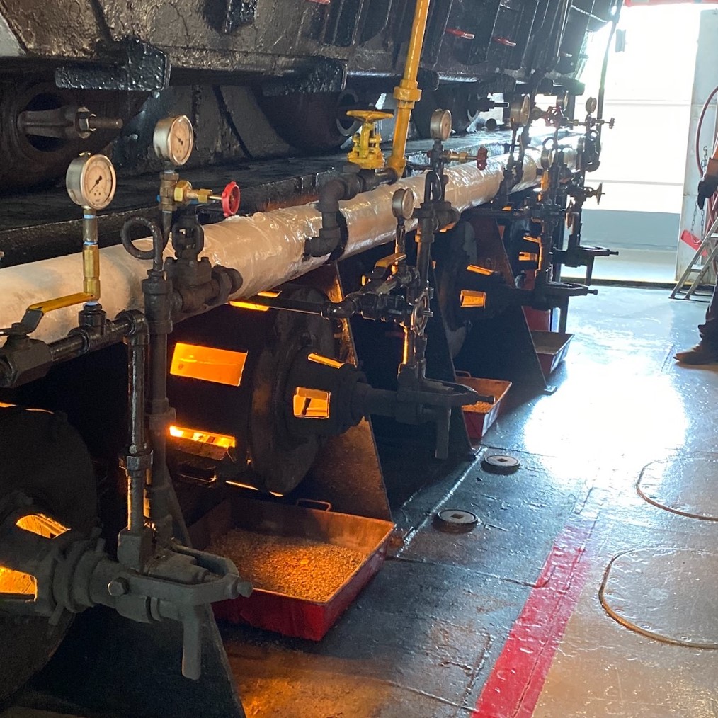

I'm keeping my day job, but now moonlighting as an "Assistant Engineer" on a steam vessel. I responded to a help wanted ad on Facebook, and know the crew, so an easy task. They need relief engineers for the full time crew to take vacation or sick days. Currently there are three "Chief Engineer" qualified crew, and another 4-5 of us. It takes three in engineering to operate the boat. USCG jurisdiction.
Belle of Louisville, Louisville, KY!

The apparent problem with Sabino is that it is a small boat with a single person engine crew and no normal economic reason to have an apprentice accumulating service hours onboard. The larger boats such as the Belle of Louisville require multiple crew of different skill levels and this provides a pipeline of new labor.
