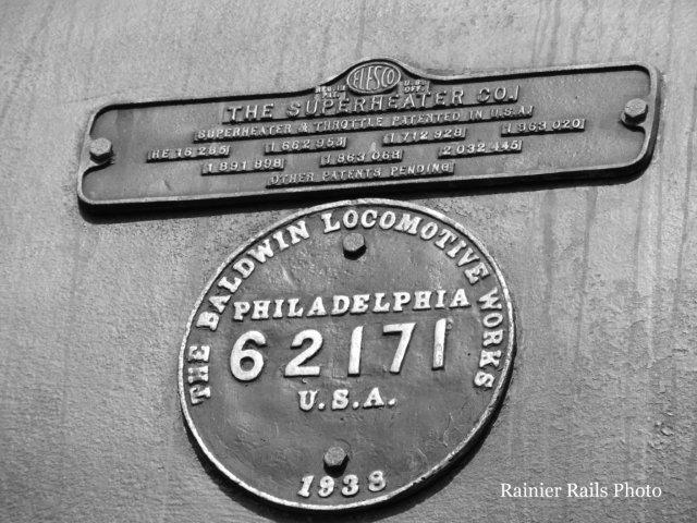

I have an engineer’s side photo of 565 taken in Dansville, NY, while on the Dansville and Mount Morris, some time prior to June 1949 that shows a Superheater Corporation Patent plate installed on the smokebox. The D&MM was a small short line daytime-only operation. As far as I can tell, the D&MM ran the loco, maintained the loco, and removed much of the unneeded electrical appliances, including the tender backup light and the train control box in front of the smokebox. It is highly unlikely that they would have added the Superheater plate after they acquired 565 from the DL&W in 1936, so all indications are that the Superheater plate was applied at the time the loco was upgraded by the DL&W.
Unfortunately, the plate is now missing. The last photo I have seen that shows the plate was taken in 1976 at Wayne, NJ as 565 was being loaded for transport to New Hope, PA. All that remains is the outline in the paint.
As to the frequency of the installation of these plates when a loco was modified with superheat, I have examined 17 engineer’s side photos of 12 of these Moguls (not including 565) while in service on the DL&W taken subsequent to the installation of superheat and only one locomotive, 543, is shown to have a Superheater plate installed on the smokebox.

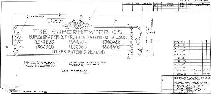

How about a good drawing of one of the plates (circa 1925);
http://photos1.blogger.com/blogger/6470 ... 0plate.jpg

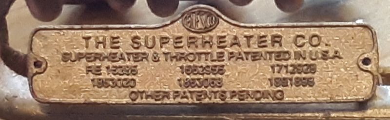

SP&S #700 has a Superheater plate:
Ted Brumberg
 Post subject: Re: Those Superheater Corporation Patent Plates
PostPosted: Thu Mar 06, 2014 8:39 am
Interesting that the builder's plate has no month on it, just the year. Is it an original or a repro?

For a 1/8 scale 1944 vintage USATC Consolidation I am building I wanted an Elesco patent plate. So I used the drawing specified for the locomotive in the Baldwin card index to model it in 3D cad, printed it on a 3D printer, and investment cast it. I was disappointed when I compared it to the plate that came off of the prototype locomotive. That plate only had a single patent number, not several as indicated in the drawing. The drawing says that Elesco provided the patent plates and my guess is that most of the patents ran out between the time the drawing was done and 1944, when the locomotive was built. Since Baldwin wasn't providing the plates they must have thought it wasn't
important to update the drawing.
