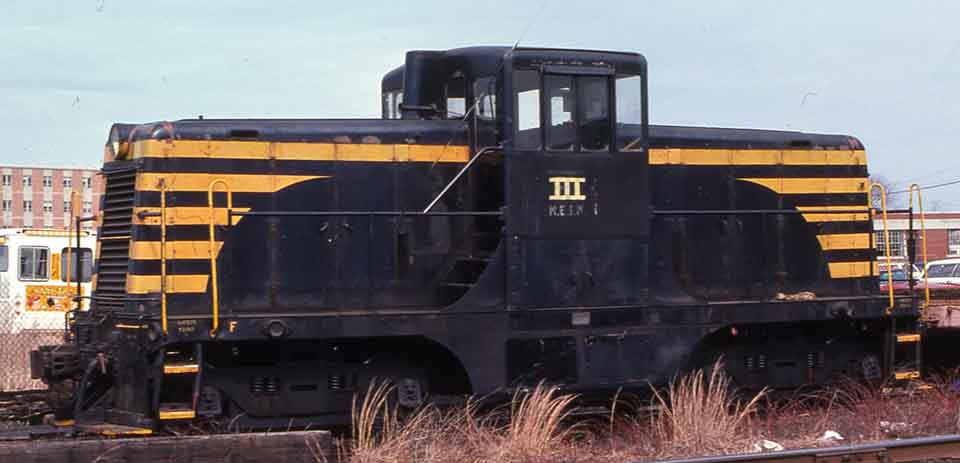

PostPosted: Tue Aug 15, 2023 4:43 pm
Joined: Mon Jul 31, 2023 6:15 pm
Posts: 1
Here's an image of the locomotive in Cambridge in 1976 when it was West End Iron Works #3 (or III, because it's Cambridge?). This company established a plant on Rindge Avenue Extension in 1946 and closed it in 1983.
Does anyone have information about other locomotives the firm might have owned?
Charles Sullivan
Cambridge Historical Commisssion
