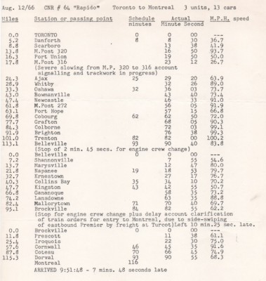

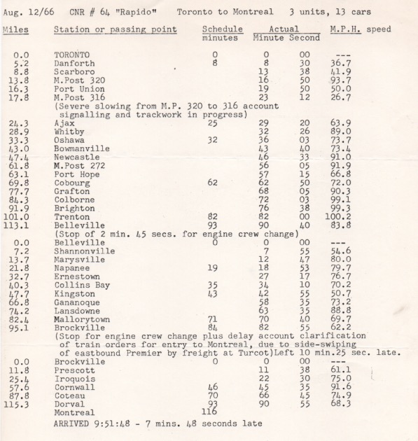

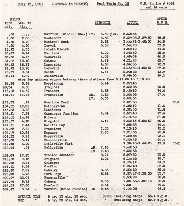

Came across these in an old folder. The two time and speed sheets were together. I added a couple more pieces from timetables. Not sure that there was any greater purpose of them being together, and I am not sure where they came from. I suspect they were sent by an old friend, John Welsh, from Montreal. That would have been some 50 years ago!
Anyway, there is sort of a comparison between mainline steam and first generation diesels. Pool Train no. 15 was The International Limited, running through to Chicago. It was pulled by a Canadian National Railways Mountain Type no. 6064. Its 14 cars would have been heavier models, with at least one diner and a parlour car and a "compt. parlour?" Sleepers were added at Toronto.
Looks like 6064 did a fine job, losing time for a stop near Aultsville. With coal stops and crew changes at Brockville and Belleville, the boys got in some 85mph running and arrived in Toronto a minute early.
The Rapido was 13 cars hauled by three GMD or MLW F units. It would have been a much lighter train with 1950s-vintage coaches and a snack counter. I think they used a club car also. Note that traditional work rules had them making crew changes at Belleville and Brockville! However, some 100 mph running helped speed things up.

Oh, the 1966 Rapido made no scheduled stops.

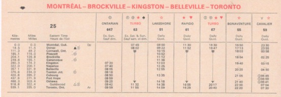

For comparison, here is the timetable from 1974. The crew changes were removed, but suburban stops were added at both ends.
I can verify the 100 mph runs on the Rapido. It was quite exhilarating! Rode the Turbo also, and it would sometimes hit 110 mph, maybe more briefly.
Not sure what the top speed of 6064 was? Maybe she could have marked 100 at times?
Oh, I looked up VIA Rail on line. Today, they can run between the two cities in 5 hours. I'd sooner ride no. 15!

PostPosted: Sun Jul 23, 2023 3:24 pm
Posts: 445
Location: Ontario, Canada.
joe6167 wrote:
A couple of the scans are so small as to be unreadable.
Yep, this site doesn't load higher resolution scans. Luckily, the 1948 and 1966 runs came through okay. The one blurry one is just the fall 1948 public tt showing no. 15, and others. I tried posting a smaller item from that page showing the accommodations on no. 15, but it was pointless to post it. It showed: Coaches; Diner; Parlour - 3 cars; and it looks like two cars added at Brockville from Ottawa; also a "Compartment Parlour." Fairly heavy train.
The other blurry one will be the 1974 tt, for comparison. Removing the crew changes, CN got the Rapido across the line in 4-1/2 hours, and the Turbo in under 4 hours.
In the '70s, there were also "all-stops" trains like the Lakeshore and the Bonaventure. They made the run in just under 6 hours and switched Ottawa cars at Brockville, so not much better that no. 6064 in 1948. There was also the overnight Cavalier.
I guess this is really a "Railfanning" thread, and the moderators may move it without any backlash from me. In my defense, it does suggest that steam passenger operations can be run crisply! Even in the '70s, CN ran no. 6064's sister, no. 6060, in regular service from Toronto to Niagara Falls, and did it at mainline speeds and on schedule.
The mid 1970s' was CN's last gasp at passenger service. The company added trains in "The Corridor" and did a great job of it. Then everything was passed over to VIA Rail, and , well, 'nuff said!
