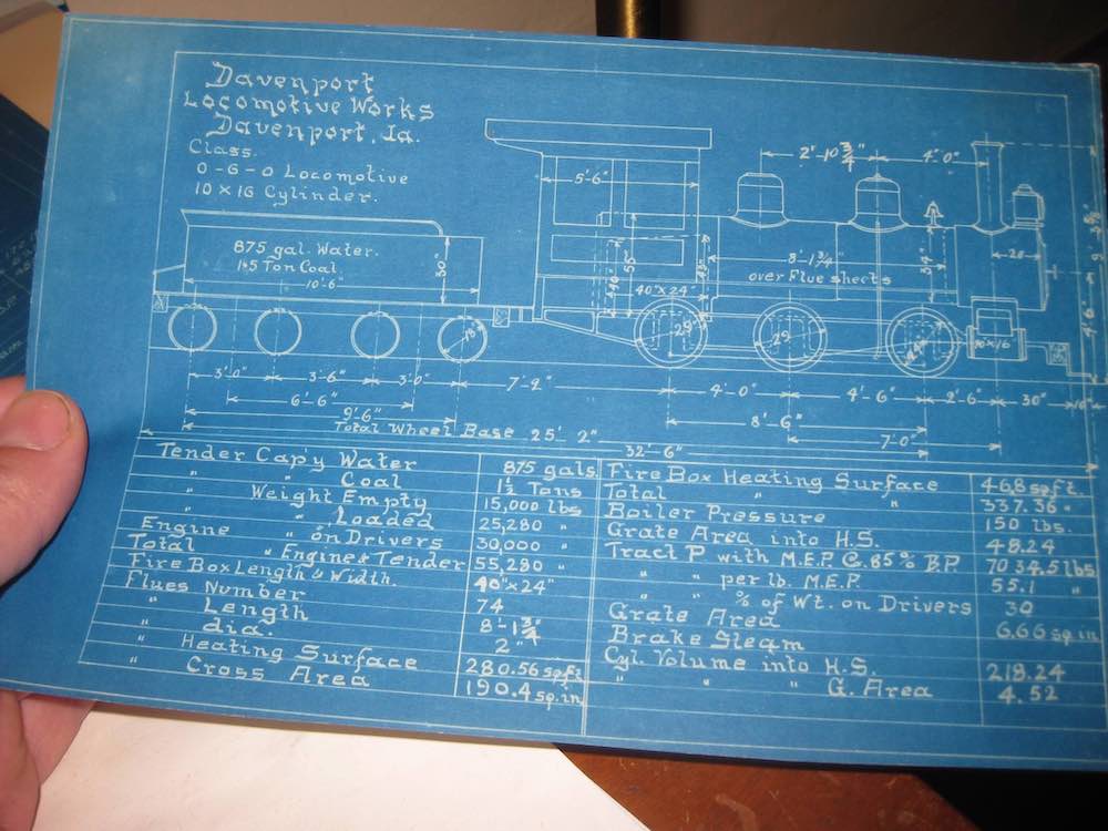

A group I am involved in (non-railroad) recently acquired a boiler. In closer examination of it, I believe it was repurposed from a narrow gauge Davenport tank engine. The boiler number is 1385 and was built April 30, 1909 and rated at 190 lbs. Later is was covered to a gas fired boiler for either steam or hot water service. The boiler has a 34" barrel and 9 ft tubes. The dry pipe and throttle arrangements were removed.
In the ideal, the group would like to use it to drive an Atlas mill engine to run a demonstration sawmill.
So, the questions are: Are Davenport boiler numbers the same as the builders number (which would be an interesting historical bit). The other is if anybody had erecting drawings for a Davenport of this size, with an eye on data for certifying the boiler (if practicable).

Davenport drawings are held in two places, a private collection in California, and in a Canadian Museum (Canadian Museum of History?) as part of the Canadian Locomotive collection. Access to either is a slow process but both are preserving drawings which otherwise would be lost…
Finding (any) drawings of your boiler will require identifying it…
Randy Hees

Posts: 550
I was able to acquire some Davenport erecting drawings on eBay a few years back, so there are other holdings out there.
This little 0-6-0 is the closest I have to your boiler, with a 34" barrel and 8' 1.75" tubes, so I would imagine it was something similar.
I hope this helps.
-Philip Marshall
