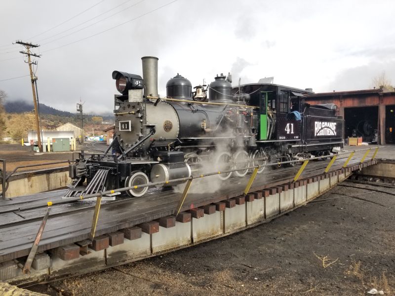

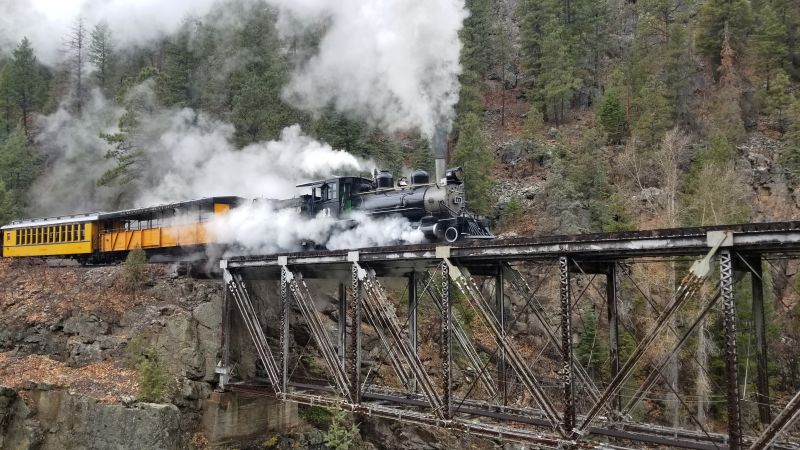

Here are some photos.

Whoa!!! I didn’t realize it went all the way to Cascade. I know why they couldn’t do it easily but I would have paid lots of $$$ to see and / or ride on her home rails. I’ve got photos from the berry farm though so I shouldn’t be too upset.

Yep she went to Cascade on Sunday the 19th. Friday the 17th she ran light to Rockwood, Saturday the 18th she to Rockwood again but, with Gon 402 and caboose 0540. Sunday they added coach 332 to the consist and because she was performing so well it was decided to take her to Cascade. We even did a runby at the high bridge. I got lucky enough to fire her a little on Sunday below Rockwood, she runs like a dream and fires very well.
