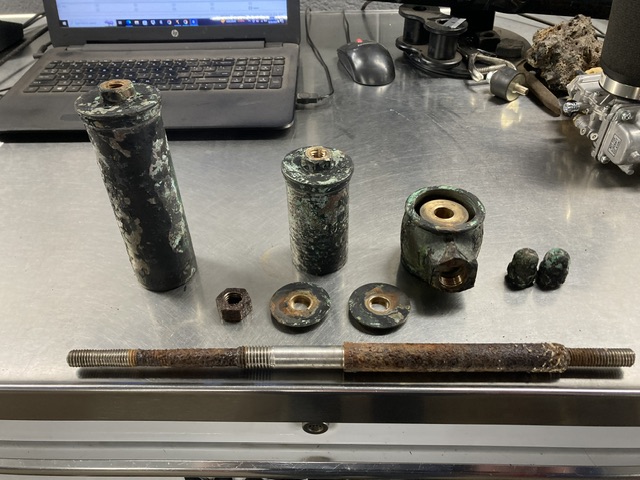

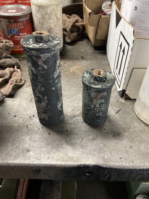

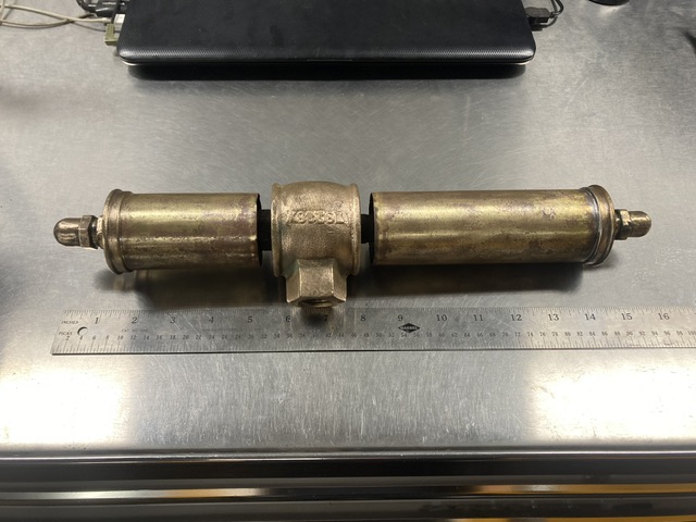

Apparently #67 was used in many push/pull moves.
The caboose would have been the leading end of the train for nearly half of its travels.
The Monongahela RR added a whistle and even a brake stand, with gauge, on this caboose because of its frequent task of being the first car at grade crossings!
Sorry for the long build up, but here is that whistle. Had to cut through a few coats of paint and repair some damage.
It’s a two chime. That is, two one chime whistles with a common base. It’s the first one I’ve seen like it. But, I’m also relatively new to Railroading… My previous experience is with single or three chime whistles.
I won’t give this one my normal polish treatment. It will live outside and get a nice oxidation patina.
Sounds nice too!!

Other roads had similar setups. P&WV had air horns on the cupola roofs for signaling the locos. I’m not sure about the brake valve - I’d need to go back and look at some plans and images. EJ&E had a small automatic brake valve in the cupola as well as your usual emergency dump valves. Not sure about an air whistle or horn, though. You’d see these setups if there were a lot of backup moves, especially if the moves were over grade crossings.
With MGA, there’d be a lot of backup moves setting out or picking up cars at the mines.
