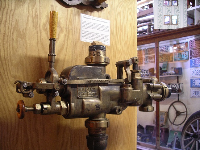

I have a Metropolitan 4 1/2 0 injector that I would like to find some info on.
What pressures and delivery rates does this operate at?
Could this have been used on a locomotive, or some other steam powered equipment?
What year range might this have been manufactured?
Thanks in advance for any info

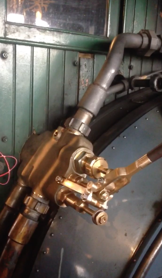

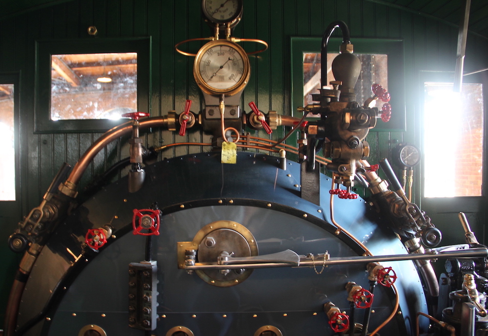

Detroit & Lima Northern #7 at the Henry Ford does indeed use Metropolitan Injectors. It came with two consecutively serial numbered (7 D if I recall correctly) and I've been informed a brand new injector has been recently replicated.
File comment: Originals, photo from 2013
File comment: Replicated Injector.

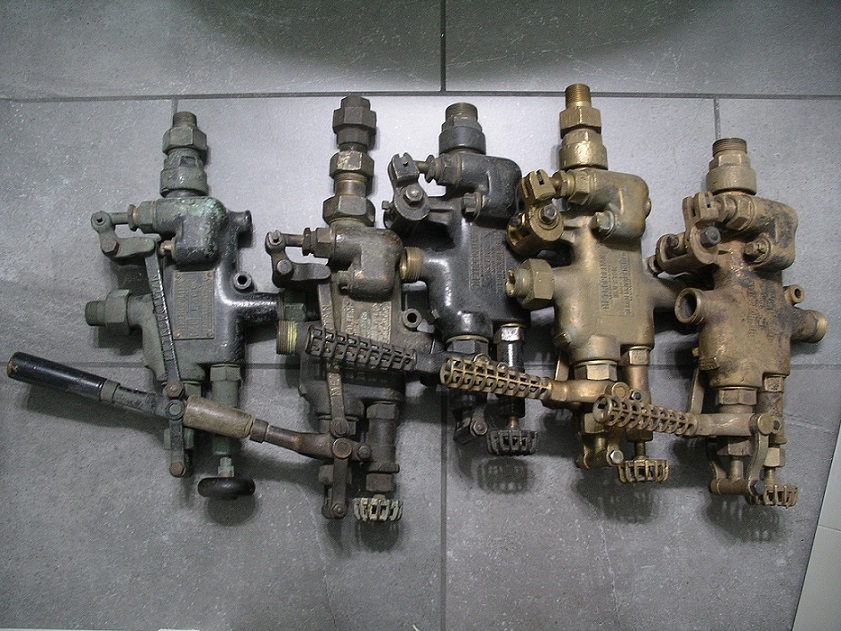

Chris, thanks for showing the new injector on Detroit & Lima Northern #7.
How many new injectors were made?
I saw this 18-1/2 O at Heritage Acres museum, Saanichton, BC, in 2009.
I collect smaller size injectors for various projects, like these 6-1/2 O's.
Some are NOS. One has a Porter 2H size tag.

Slightly off topic on the Henry Ford loco. Why was the decision made to change the live steam line to steel with the replacement injector..? That and the large union seem like a step backwards in the effort to recreate a historically accurate 19th century Baldwin loco.
Definitely not knocking the museum down with their beautiful locomotive, but very curious about that decision.
